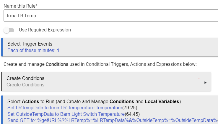

Using periodic schedule to trigger Rule 5.1 to execute rule on a periodic schedule in order to log temperature data to google sheets. The rule works as expected if interval is set to 10 seconds but after changing the interval to 1 minute, the rule executes every 1 hour instead. What may be the problem, me or a bug?
That would mean trigger at 1 minute after the hour, every hour.
Try something like this:
I should have known, the problem was me :slightly_frowning_face:. Thanks very much for your response. Working like a charm now.
