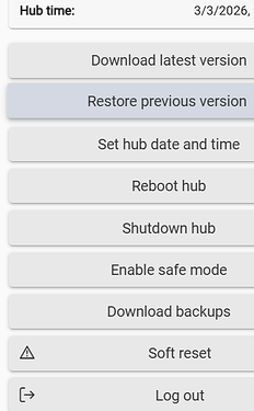

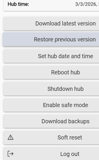

If you want to directly test the platform version, you can roll back to the previous version you were runnning before 2.4.4.135 and see if your issues w/the contact sensors persist.
  1. Launch the Diagnostic Tool from Settings>Diagnostic Tool
  2. Choose the Restore Previous Version option
  3. Select the previous version to restore to

Tried downgrading the platform and no improvement.
