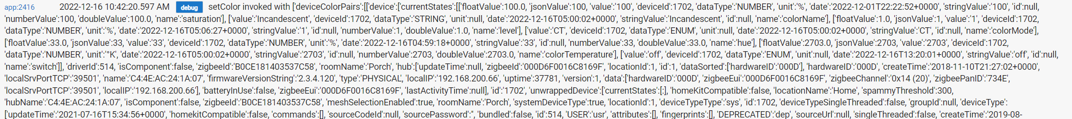

...and I'm not actually sure it's a string; actually it looks more like a Map. But I suspect that's because it's round-tripping through a string.

private setColor(data) {
    debug("setColor invoked with ${data.inspect()}")
