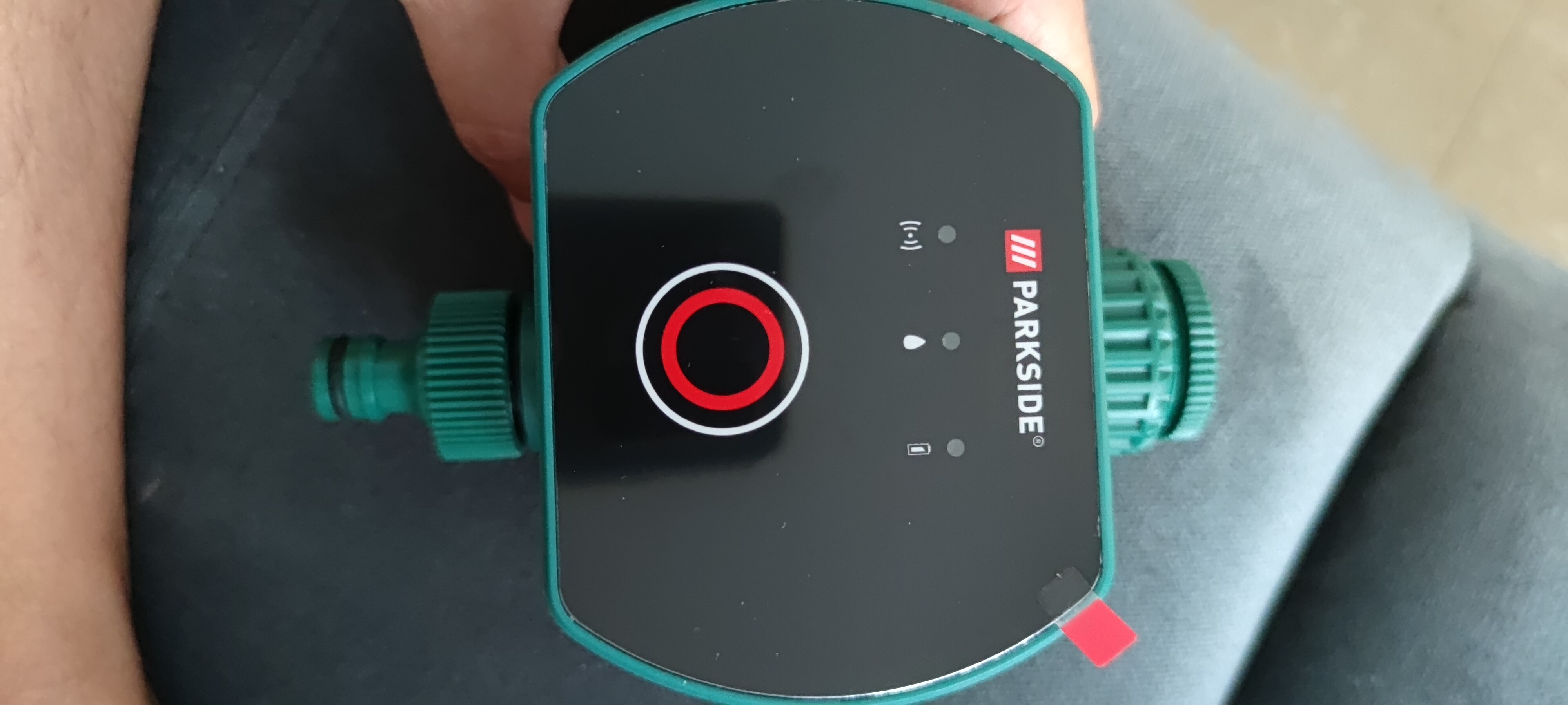

Need help, I buy a Smart watering timer from Lidll and bring in HE using GE outlet drivers, is working but after 1m is closing, status remains open.
Anybody have any drivers, idea???
