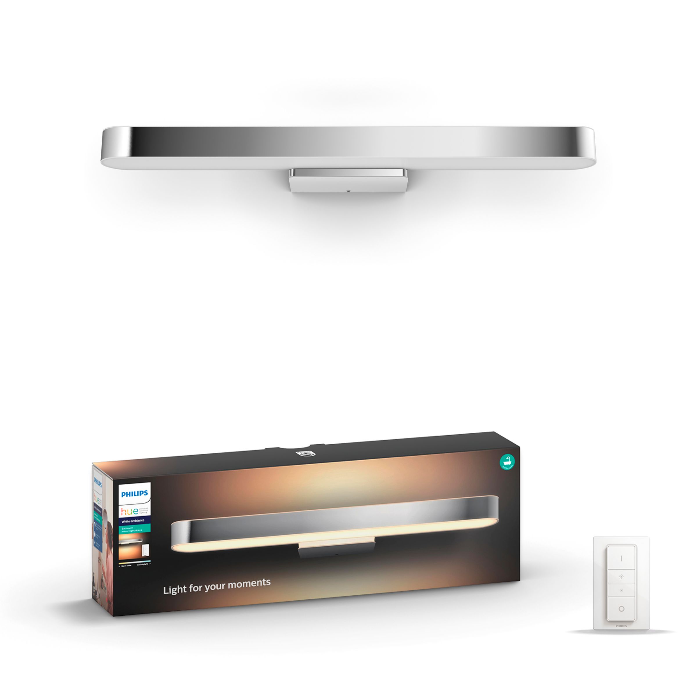

Hi, I'm trying to pair my Hue light directly with my Hubitat while simultaneously keeping the paired remote connected to the light. is this at all possible or can i only pair it to one thing at the time?
I do it by pressing I and O for 10 seconds until the light flashes. the light is then included in my Hubitat hub. After that i simply press I once on my remote and it seems to sync up. but as soon as i do that, the light seems to loose it's connection to the hub.

Nice fixture. I'd buy the bridge just for that. It looks worth it. Pickup that used one I posted. You don't have use for the bulbs right now, but you'll find some use for them eventually and then you'll be glad you had them. They're nice bulbs and that price is less than a new bridge alone, so getting three bulbs for free is a sweet deal.
