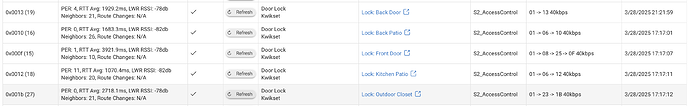

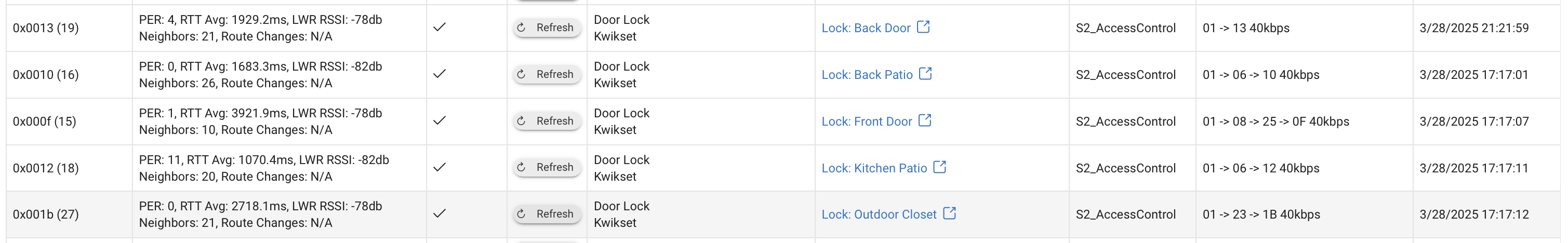

I have 5 of these locks on a C-8 Pro, which has the same z-wave chip as the C-8. No issue connecting them. I used Smartstart on an iPhone to pair them. They all paired with "S2 Access Control", as anticipated.

Can you post screenshots of your z-wave settings page in its entirety? It seems likely you have one or more z-wave ghosts.

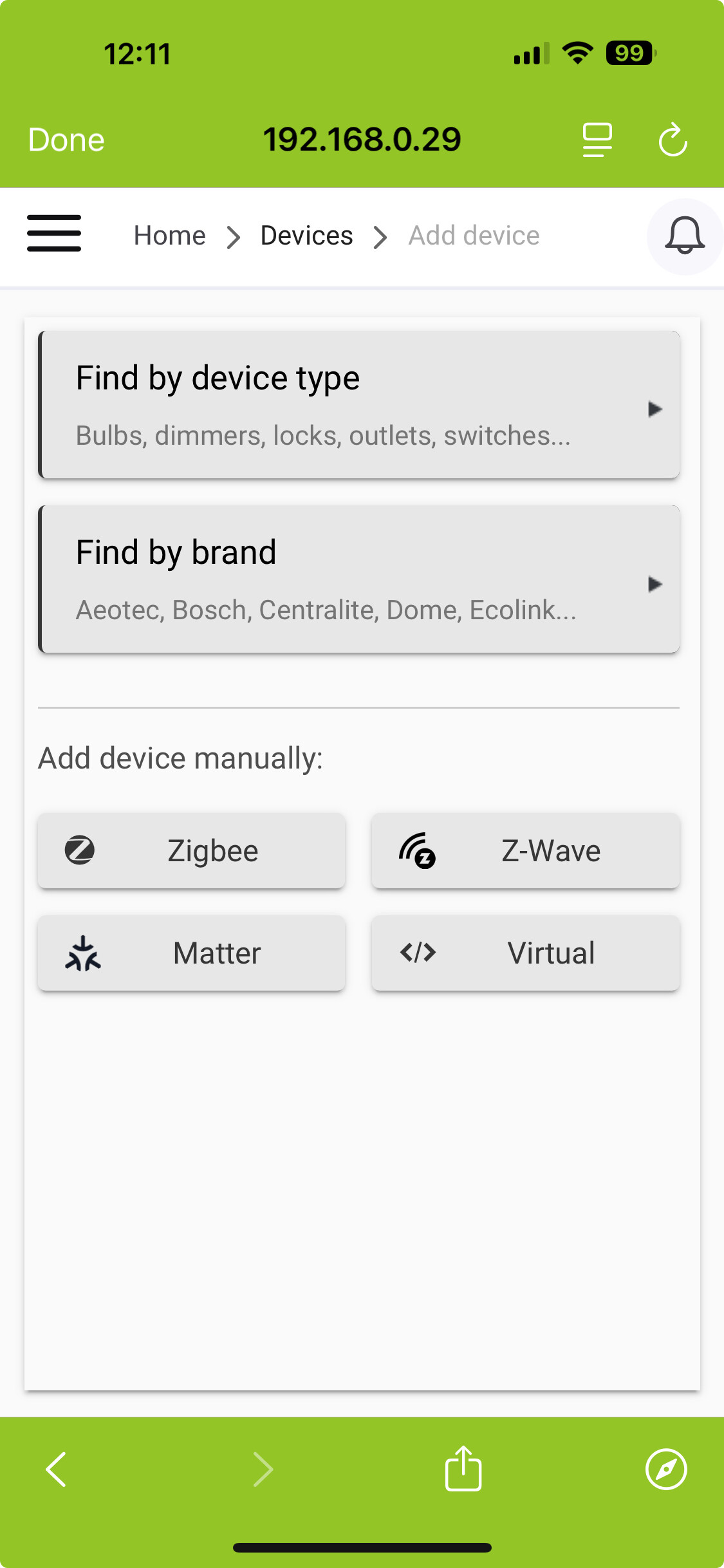

You can only access the SmartStart (SS) pairing option from the Hubitat app, you can't do it from the webpage. And that option will only be availble in the app when you're connected to your local network (i.e. wifi, not cellular).
Are you on Android or iOS? There's currently an issue where the SS option is not showing up in the app at all for net-new app installations.

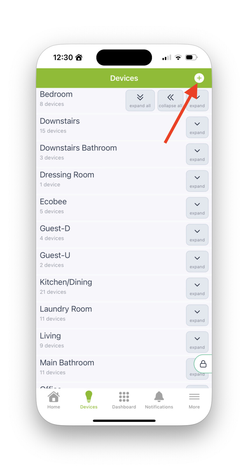

  1. Open the app, make sure it indicates your connection is Local, and Click on Devices.
  2. Click on the + sign in the upper corner (right hand or left hand - depending on your OS and app version)
  3. Click on Add Smart Start Devices

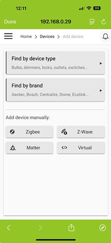

That's just the regular website rendered to mobile (viewing) size.
As long as your phone's on your local network (connected to wifi), you don't need the app to get that page; you can just use your phone's browser to access your hub directly.
