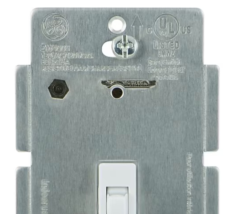

If you can remove the cover and post a picture of the installed switch it may help to identify a proper exclusion procedure.
