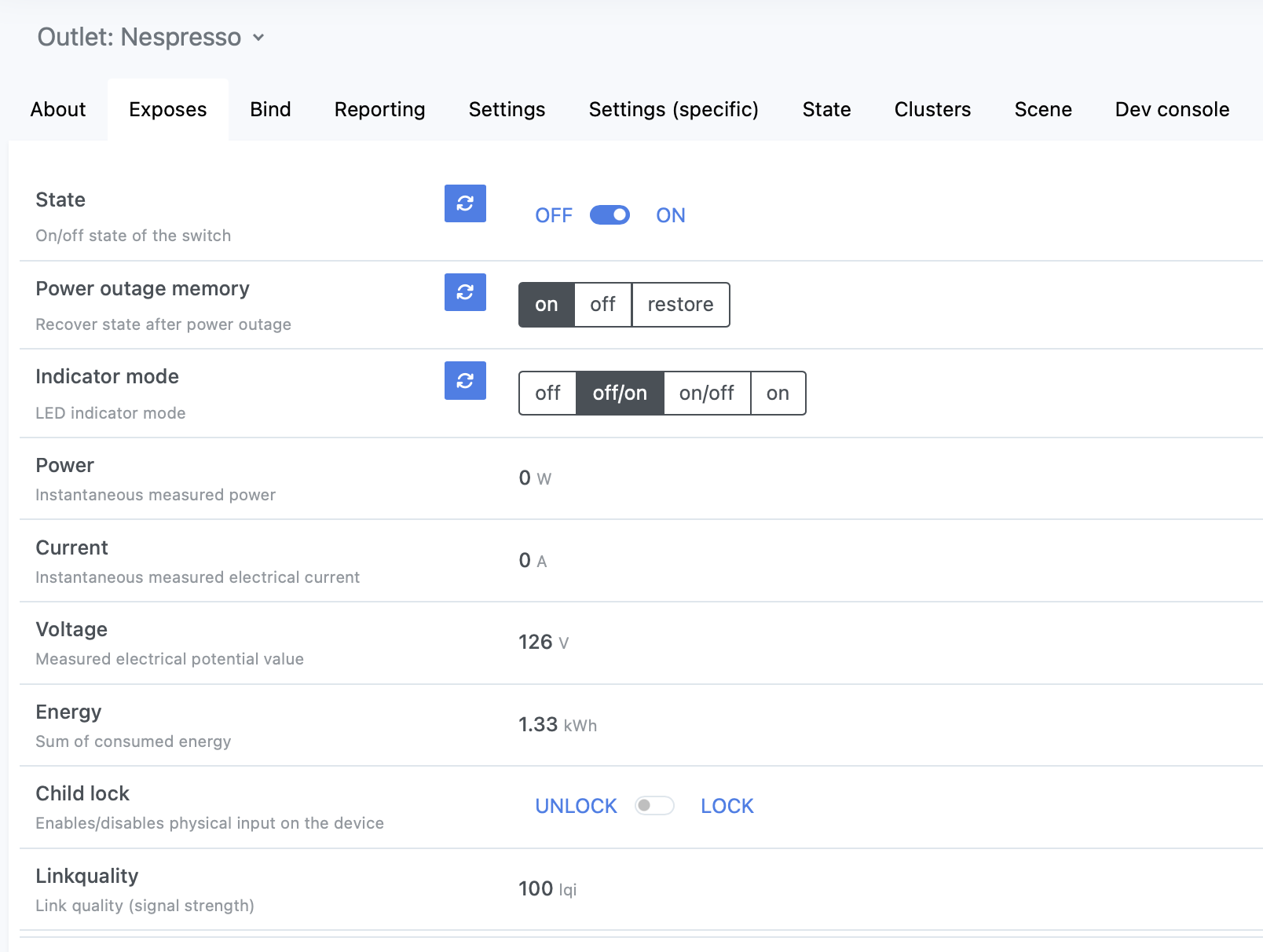

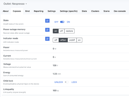

I have a couple zigbee Tuya outlets that apparently can be configured to turn on after power restoration, even if the coordinator is not up and running. At least z2m permits such configuration (power outage memory).
Worked perfectly. Here's how I tested it:
  1. Configured the plug using z2m to turn on after power restoration.
  2. Powered down the coordinator and radio.
  3. Turned the plug off, and then pulled it out of the outlet.
  4. Plugged the plug back in - it turned on pretty much instantly.

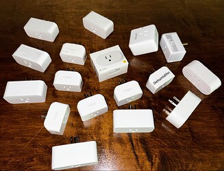

As to cost, I guess I was assuming everyone's junk box has a bunch of these
