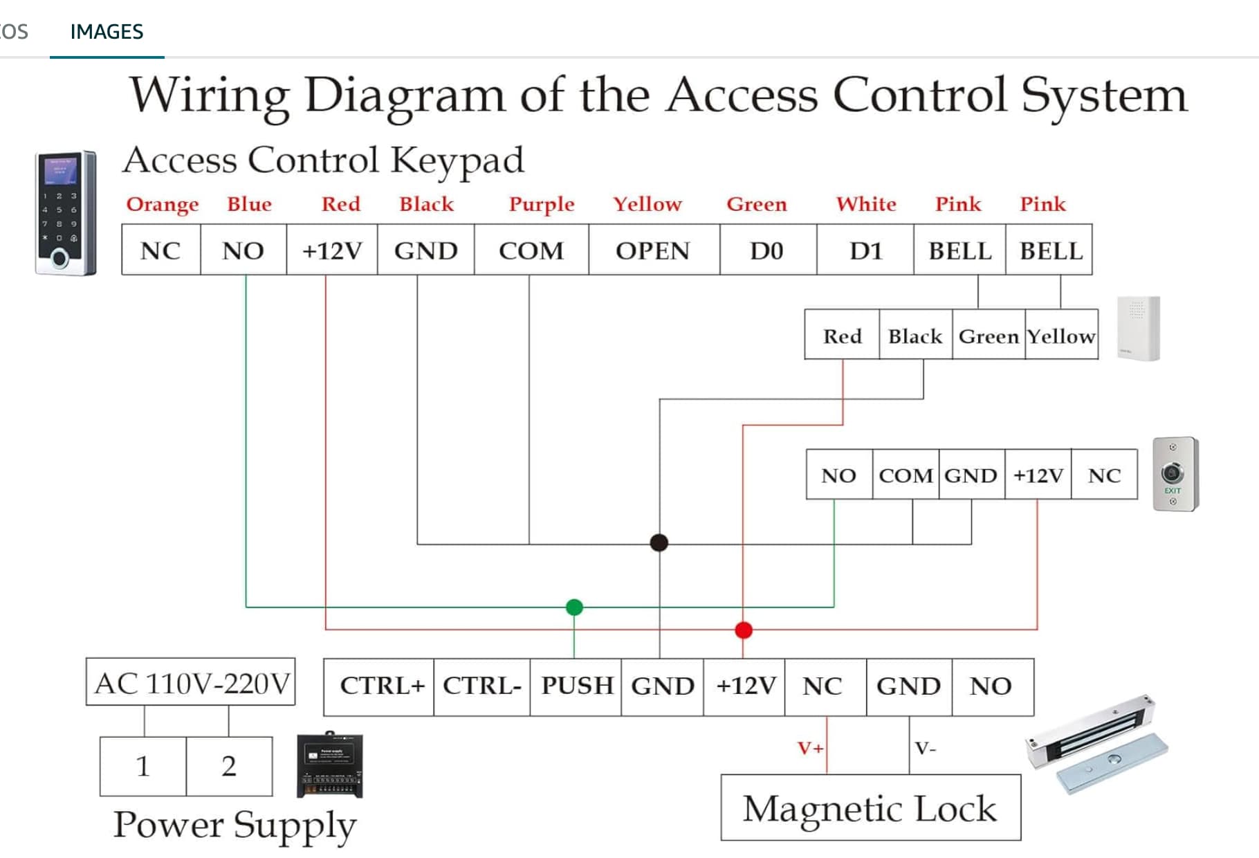

Could something like this be "hacked" (in the 1980's definition of hacking!) by connecting to a Zooz ZEN16/17 or other devices, which would be inside the garage? Here's a wiring diagram. Looks like it needs 12V and will contact a door bell (one relay), and another contact to "de/energize" the magnet (second relay). The rest of logic would be in the device, which I guess would be ok to manage directly.

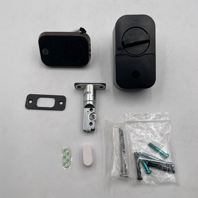

What about a used smart deadbolt/lock? Maybe with some hacking (disabling the motor for example) you could still have it functional otherwise. This way when someone enters a code, it would still send it back to the Hubitat (Z-Wave or ZigBee model).

I just realized that trying to use an old smart lock wouldn't be easy. The keypad would be outside, but it gets it's power and zwave/zigbee connection from the inside part. So, I'd have to run some kind of extension wire and mount the inside part inside the garage.
It also mounts from the inside screws. So mounting and keeping the keypad waterproofed would be difficult if not impossible.
It seems like a generic compatible wireless keypad would be the simplest and possibly least expensive solution.
I have three of those, but they simply replace the inside knob/lever of your existing deadbolt lock. They do not come with a keypad. I like them because my existing key still works, resulting in a very high WAF. We actually hardly ever use these doors, however. We mostly leave and enter the house via the garage doors. It would be nice to have a numeric keypad, so this thread is interesting to me. :thinking:
After weeks of searching, I accidentally came across this a few minutes ago with a screen, fingerprint, RFID, and pin code: Amazon.com: Wireless WiFi TUYA Access Control System with LED Screen/Voice, Fingerprint Password Stand-Alone Door Access Control Keypad, WG26/34 EM Card Reader Access Controller, Full Metal Weatherproof : Electronics
And this one without the screen, but with video: Amazon.com: Smart WiFi Video Intercom & Doorbell Tuya Access Control System, All-Metal Fingerprint Keypad 1080P Night Vision Camera, Video Monitoring, Fingerprint/Password/Card/Tuya APP Remotely Unlock : Electronics
It's Tuya, and works with Tuya and/or Smart Life app! So possible to get it into Hubitat? If not directly, then indirectly - I might be able to connect an extra zwave dry contact to signal "door opening".

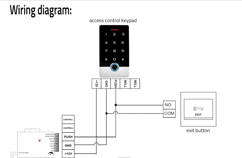

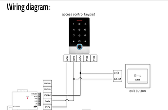

I'm down to these. Both have RFID, Tuya app, keypad.
$30
https://a.co/d/0g2rEe7P
This one has added fingerprint for $60.
https://a.co/d/0gj8GpqX
Any red flags, thoughts, comments?
The only warning I see is that you would need to run them both power, since neither are a battery keypad.
The first one does not have it clearly, but in the produce video title screen you can see 4 wires running to it.
The second one is clearly for garages to begin with and has a variety of connections (and a diagram for them). Heck, with that you could bypass the Tuya app (after initial setup) and use a i/o device to see when it sends the signal to open the door.
