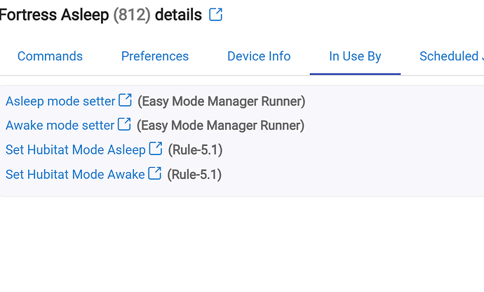

C5 running 2.4.0.148. Added "asleep" and "awake" modes with triggers to a device being on or off. Later, I deleted the modes but the triggers "awake mode setter" and "asleep mode setter" remain out there somewhere, the device shows they are referenced and logs show them executing. Worried this may be a problem. Looks like they are hidden rule machine apps. How do I delete these?
Ok, looks like adding the mode with the same trigger, followed by deleting the trigger then finally be deleting the mode removed the orphaned trigger.
