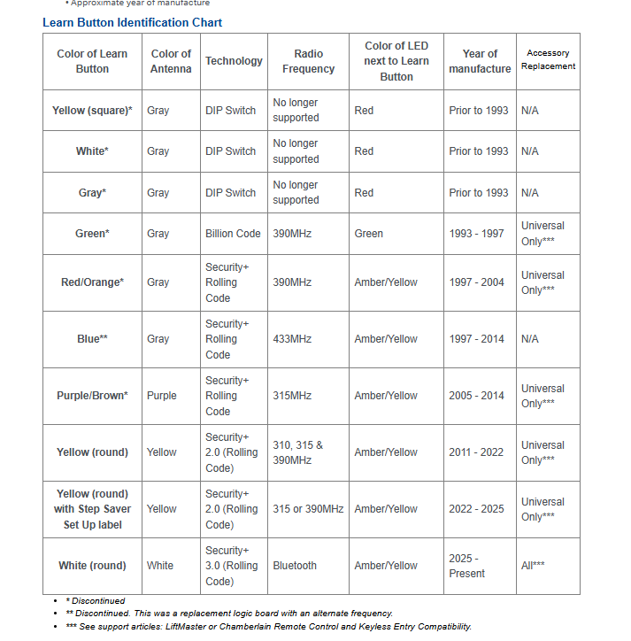

Is Chamberlain the same as Liftmaster? I got a new Liftmaster garage door opener installed, which has prompted this thread.
I would love to know I'm incorrect in assuming my new opener is 3.0.
It has a white learn button, which I read is indicative of 3.0. Whereas 2.0 uses a yellow learn button and 1.0 is either red or purple.
Yes.
I believe that is 3.0, unless it is a very old device.
From the Chamberlain site:

Yes they are the same but liftmaster got the new security first, still some Chamberlain with the yellow buttons. When I heard about the new protocol back in december, I right away went out and got 2 new Chamberlain direct drive openers on sale before the new ones come out even if I will only be installing them in a year or so because my new house has not been started yet. A friend of mine, who works in garage doors, told me that the liftmaster in Canada has been on security 3.0 for some time now, he started seing them back in september 2025 and when they got clients that absolutely wanted the 2.0, they would point them to go buy the Chamberlain version in store and would install it for them at a premium as they usually don't install end user bought units.
Yes that is 3.0 for sure!

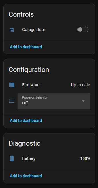

I just got the THIRDREALITY Garage Door Opener today and when pairing it onto Hubitat (from another Matter fabric), it comes into Hubitat with no device type. I changed its device type to "Generic Matter Switch" and it seems to be working well.
But I'm still curious if you faced something similar and what you ended up setting your THIRDREALITY device as in Hubitat.
I don't recall the whole saga, to be honest. It was back in January. I just remember that it had a hard time paring with Hubitat directly and then operating correctly, but it paired OK first with HomeKit and then to Hubitat. I'm willing to admit that part of the problem might have been between the chair and the keyboard. It works fine the way it is so I'm not inclined to fix it.
The only thing I've noticed is that if I unplug the base unit and plug it back in (simulating a power outage), it takes a minute or so for it to reconnect, but it does so automatically on different fabrics (e.g. Home Assistant). But on Hubitat I have to press a button on the device page (e.g. on, off, or configure) for it to sorta sync back up. Maybe it'd do it automatically if I waited long enough though.
The only other downside as I'm having to use a generic driver in Hubitat is that it doesn't show battery information like I see on the Home Assistant side of things.
