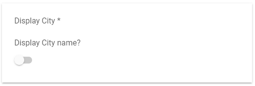

[UPDATED V0.6.7 06/03/2023]
  • Merged pull request from @nh.schottfam to allow 'City' to be displayed as a stand-alone optional attribute.

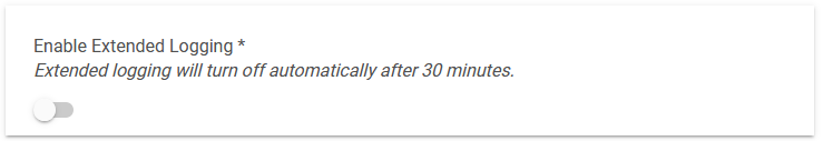

Turn on 'Extended Logging' and look for clues in the logs.
