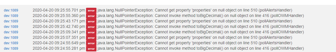

Matt. Getting an error tonight.

Matt,
Here is the latest error after the poll data is executed:
dev:10892020-04-23 01:03:07.382 pm errorjava.lang.NullPointerException: Cannot invoke method toBigDecimal() on null object on line 405 (pollOWMHandler)
dev:10892020-04-23 01:03:07.090 pm infoOpenWeatherMap.org Weather Driver - INFO: Poll api.weather.gov/alerts/active: [uri:https://api.weather.gov/alerts/active?status=actual&message_type=alert,update&point=44.302018,-92.674947&urgency=unknown,future,expected,immediate&severity=unknown,moderate,severe,extreme&certainty=unknown,possible,likely,observed, requestContentType:application/json, contentType:application/json]
Matt - I'm switching to your OWM- Weather Display Driver. Unless you need additional assisstance with testing?
The first error (line 405) indicates that it cannot find the 'visibility' data. I did not check for a null value, so I will have to add that check. That would cause the driver to fail.
The second message (that was processed first) is not an error, just providing info on the API request sent.
Thanks. This helps.

Here is OWM with Alerts:
Refresh reports no errors.
Polling error:
dev:10892020-04-23 01:56:43.737 pm errorjava.lang.NullPointerException: Cannot invoke method toBigDecimal() on null object on line 405 (pollOWMHandler)
dev:10892020-04-23 01:56:39.182 pm errorjava.lang.IllegalArgumentException: The JSON input text should neither be null nor empty. on line 507 (pollAlertsHandler)
dev:10892020-04-23 01:56:32.113 pm infoOpenWeatherMap.org Weather Driver - INFO: Poll api.weather.gov/alerts/active: [uri:https://api.weather.gov/alerts/active?status=actual&message_type=alert,update&point=44.302018,-92.674947&urgency=unknown,future,expected,immediate&severity=unknown,moderate,severe,extreme&certainty=unknown,possible,likely,observed]
dev:10892020-04-23 01:56:29.833 pm infoOpenWeatherMap.org Weather Driver - INFO: OpenWeatherMap Data: [current:[sunrise:1587640362, temp:55.35, uvi:5.59, pressure:1005, clouds:100, feels_like:50.68, wind_gust:8.99, dt:1587667835, wind_deg:66, dew_point:39, sunset:1587690283, weather:[[icon:04d, description:overcast clouds, main:Clouds, id:804]], humidity:54, wind_speed:4], timezone:America/Chicago, daily:[[sunrise:1587640362, temp:[min:42.78, max:55.36, eve:53.01, night:42.78, day:55.35, morn:55.35], uvi:5.59, pressure:1005, clouds:100, feels_like:[eve:47.73, night:33.93, day:49.55, morn:49.55], dt:1587664800, wind_deg:79, dew_point:39, sunset:1587690283, weather:[[icon:04d,

2020-04-23 02:02:43.763 pm errorjava.lang.IllegalArgumentException: The JSON input text should neither be null nor empty. on line 776 (pollAlertsHandler)
dev:42562020-04-23 02:02:40.713 pm errorjava.lang.NullPointerException: Cannot invoke method toBigDecimal() on null object on line 571 (pollOWMHandler)
dev:42562020-04-23 02:02:40.350 pm warnWeather-Display Driver - WARNING: Weather-Display API did not return data
dev:42562020-04-23 02:02:37.985 pm errorjava.lang.NullPointerException: Cannot invoke method toInteger() on null object on line 828 (refresh)

Okay, Do you have time to test again? If so the same links above.
I actually missed an occurance of the visibility being null. I fixed that. I also check for nulls on all the other OWM data items now to prevent furthur issues.
I have not anticipated that when the weather.gov returns an 'okay' (200) status, that it also returns a null value if there are no alerts. I had seen it return a populated value that I could determine that there were no alerts, but there was a return. I have corrected that if it is 'okay' it check to see if it is null too.
Thanks again for your help.
yup
No errors on OWM NWS Alerts Driver..
