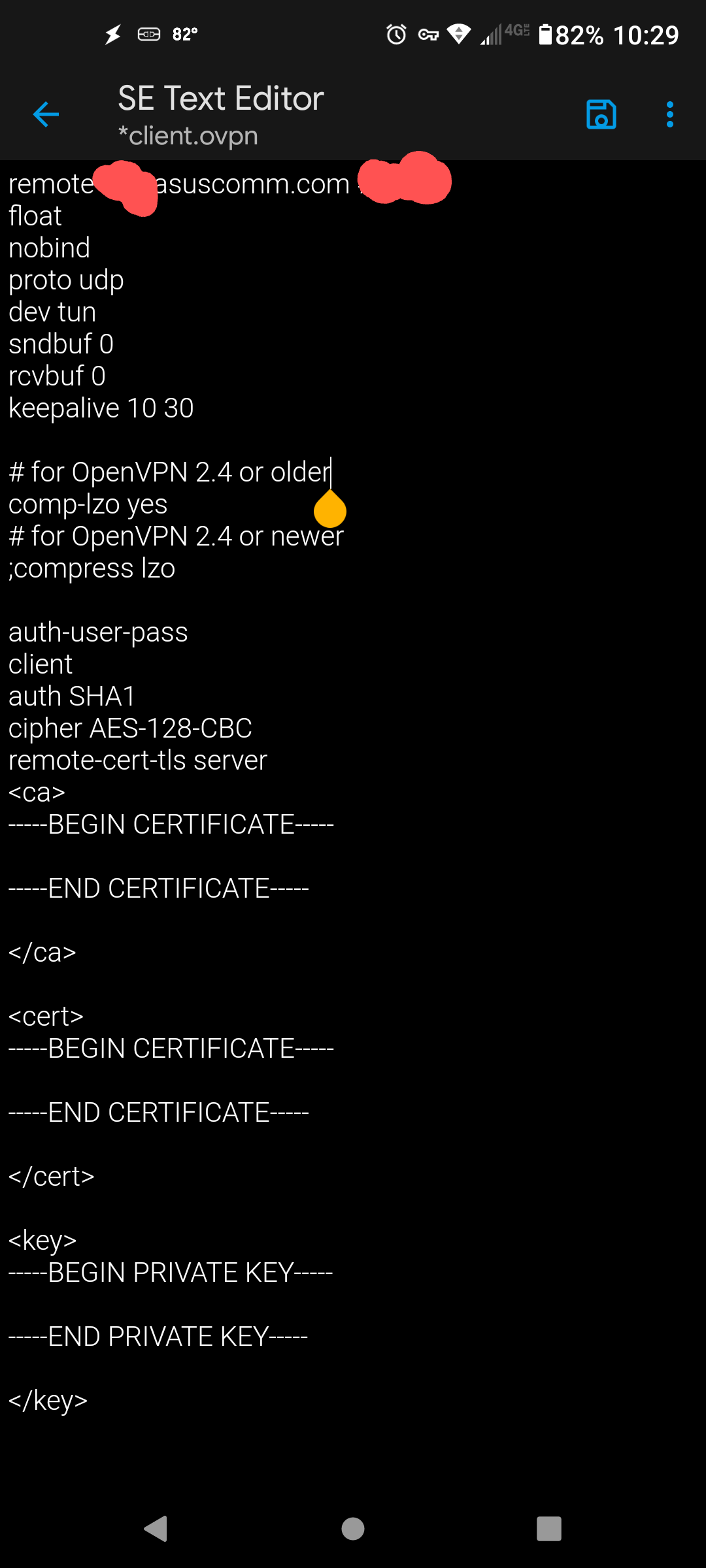

The pocket router VPN client will successfully connect to the server on the Asus but won't pass traffic. I know next to nothing about how this works. I've tried changing the advanced VPN settings in the router without success. My client.ovpn is attached. I removed what I believe to be any identifiable information. Anyone have any ideas?
What's openvpn client version? Try commenting out LZO compression entirely, irrespective of the client version.
I think it's 2.5.2 if I'm reading the syslog file correctly.
Removing LZO didn't fix it.

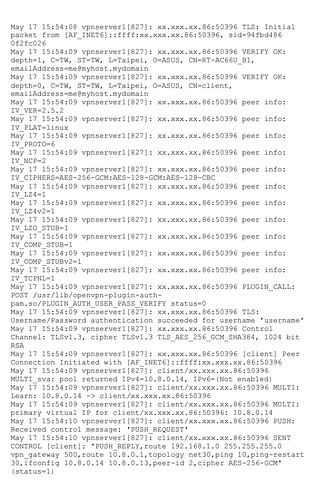

I tried the original file again and captured the logs from the asus. I see no errors. I'm going to remove identifiable information and post the log. Maybe it will help.

Here is the asus syslog when I logged in with the client file above (has the LZO references)

Your client OVPN looks okay - There are a few settings extra on mine that probably don't matter. It depends on how your server is configured of course.
resolv-retry infinite
persist-key
persist-tun
comp-lzo no
# Set log file verbosity.
verb 3
# If a tls-auth key is used on the server
# then every client must also have the key.
tls-auth "[your cert directory]\ta.key" 1

Thanks everyone. I'm thinking it has to be something with the client in the GLinet router. I compared the syslogs from when my Android connects to the server and when the GLinet connects. There are some differences, including in the cipher. It also looks like the Android version is 3 something where the GLinet is at 2.5.2 (if I'm reading the logs correctly).
