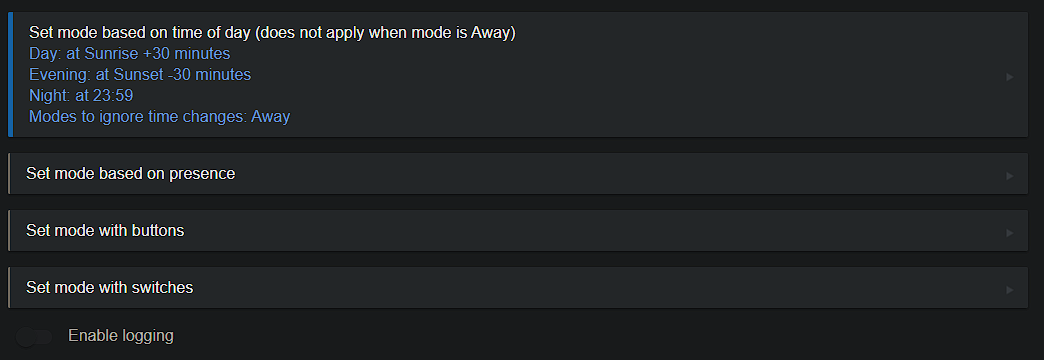

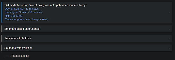

Here is my Mode Manager settings, like I said, very simple.

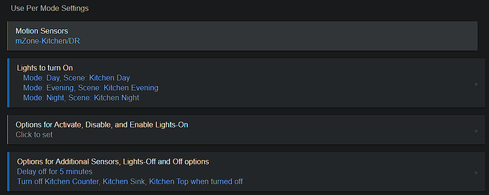

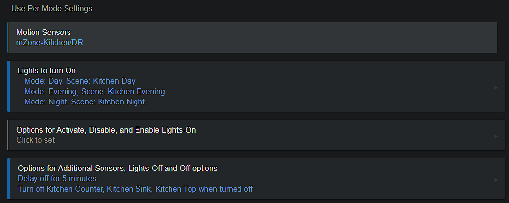

And here is a screenshot from my kitchen motion settings from the 'Motion and Mode Lighting' app.
