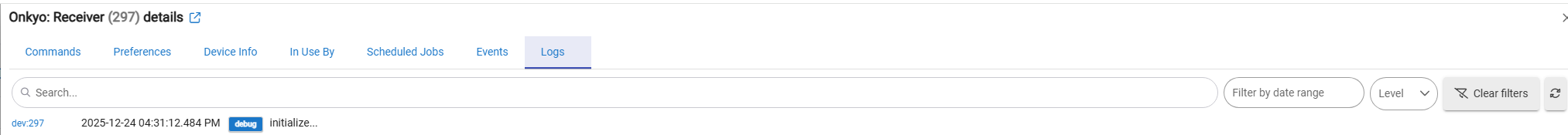

The screenshots below show an example of the offline behavior:
Once I click "Initialize" manually and the network status of the Onkyo Receiver is online:
the watch dog will only attempt to reconnect 5 times, after that it stops trying and initialize must be invoked to restart it.
