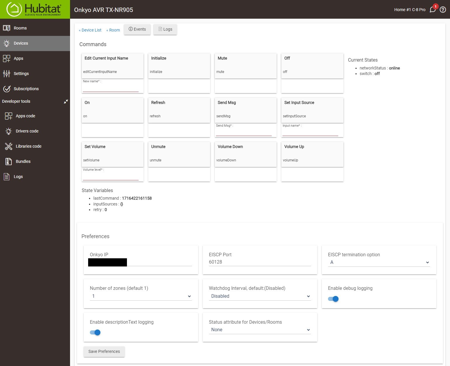

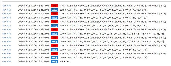

I'm attempting to operate my Onkyo AVR TX-NR905 (configured for eISCP port 60128) with the HE built-in driver (Onkyo AVR) on a C-8 Pro. According the logs, HE establishes a connection with the AVR, but the AVR is sending responses that the driver cannot parse (throws StringIndexOutOfBoundsException exceptions). This happens with both eISCP terminations (A and B).
Any assistance is appreciated. Thanks.

for some reason there's a carriage return at the be beginning of the raw data, this is producing a one off error in the parser.
Can you telnet with some other software to the receiver and see what the whole string looks like?
you will need something that just echos the ascii integer codes
This can be resolved in the driver, but this is the first I've seen of this issue...
