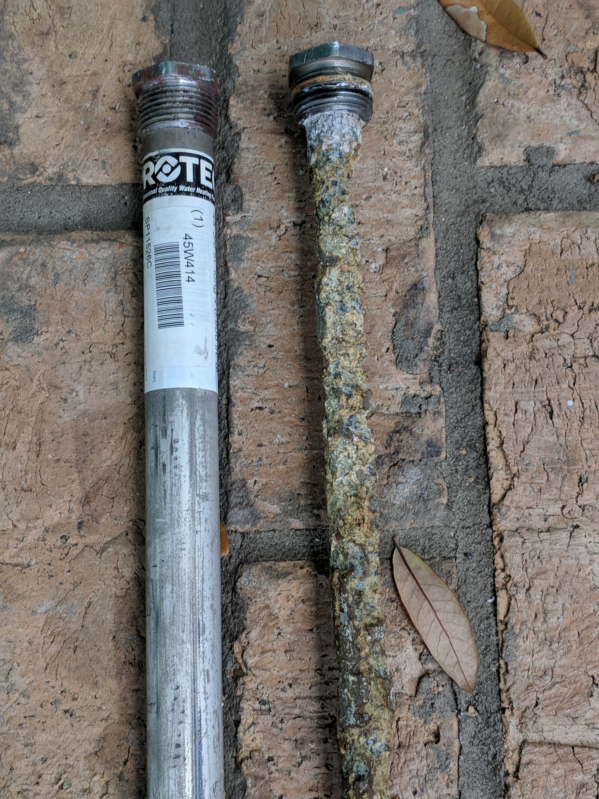

Ha - here's new and 80% consumed anodes side by side:
The crap looking rod on the right still has about 2 years of life left in it. But that's why I like to replace them around the 5 year mark. It ensures the tank remains really rust free.
That looks beautiful compared to the one I pulled out of the camper. It looked like a dipstick and was only 4 years old when we bought it. It also will get used up faster with heavy use.
Depends on the quality of water.
BTW, in addition to chlorine, water with a lot of lime in it forms carbonic acid when heated. Which also attacks metal.
We bought it in San Diego by the way. Maybe something in the water out there.
I just did a Google search and it says that SoCal has the hardest water in the United States
Well, I'm in SoCal and have been known to take a quick pee while body surfing... :wink:
Absoultely true. The tap water down here is also the worst tasting ever.
Geez...that looks scary. I'm setting a repeating 4-year reminder in my calendar to replace the anode w/a new .9 anode, and we'll see how it looks at that point. All the water in our home passes through a water softener before getting to the water heater...removes a ton of minerals we have in our water, but adds salt, obviously. Is the salt in the softened water going to make the anode degredation faster/worse? Seems like the salt will not be good for the water heater.
That seems reasonable since salt is Na and Cl, but my aunt had a water softener, so maybe not.
@danabw - you're dealing with carbonic acid driven deterioration of your water heater. A periodic flushing and anode replacement schedule is a good idea.
A little worse. Salt provides chloride.

A powered anode rod is supposidly the way to go. I'm not an expert on the subject and the primary reason for changing my magnesium anode to a powered anode was to eliminate the sulfer smell. However, I of course didn't want to introduce problems by doing that and so I did my due diligence.
Acording to this site (which may be associated with Coro-Protec in some way), a powered anode is better at protecting your tank than magnesium or aluminum anodes and is maintinance free. They're not the only manufacturer however, A.O. Smith also sells them for residential water heaters, so it's not like this is some kind of scam. Rheem support was also aware of their effectivness when I asked about substituting them for the magnesium rod. Their response that it would not void the warranty speak volumes about the effectiveness of powered anodes.
Seems like they are generally better, but because of the cost (and probably also due to the longer periods between new water heaters and support for all the related industries that are involved in flood repair and removal/installation), water heater manufactuers don't include powered anode rods with their water heaters.
Another point of reference I remember looking at before purchasing is here.
They are at least as effective as magnesium/aluminum anodes. The issue that I used to have with them was one of cost.
Powered anodes cost about $100. There was a time when metal anode rods were about $10-15. So changing rods every 5 years would cost about $50 in the span of 20 years, which is the life-span of a powered anode.
Now, metal anodes are about $30-40. So 3 changes would cost more than what a powered anode costs. So it makes sense to go with a powered anode.
