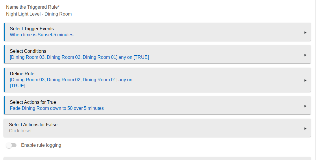

I want all lights on at 100% at sunrise and dimmed to 50% at sunset. Ideally, with a 5 minute fade up/down if the lights are on. I would also like for any of the lights to turn on at the correct level (even if during the 5 minute fade period).
I currently have this for each group, but it doesn't correctly address the fade requirement.
