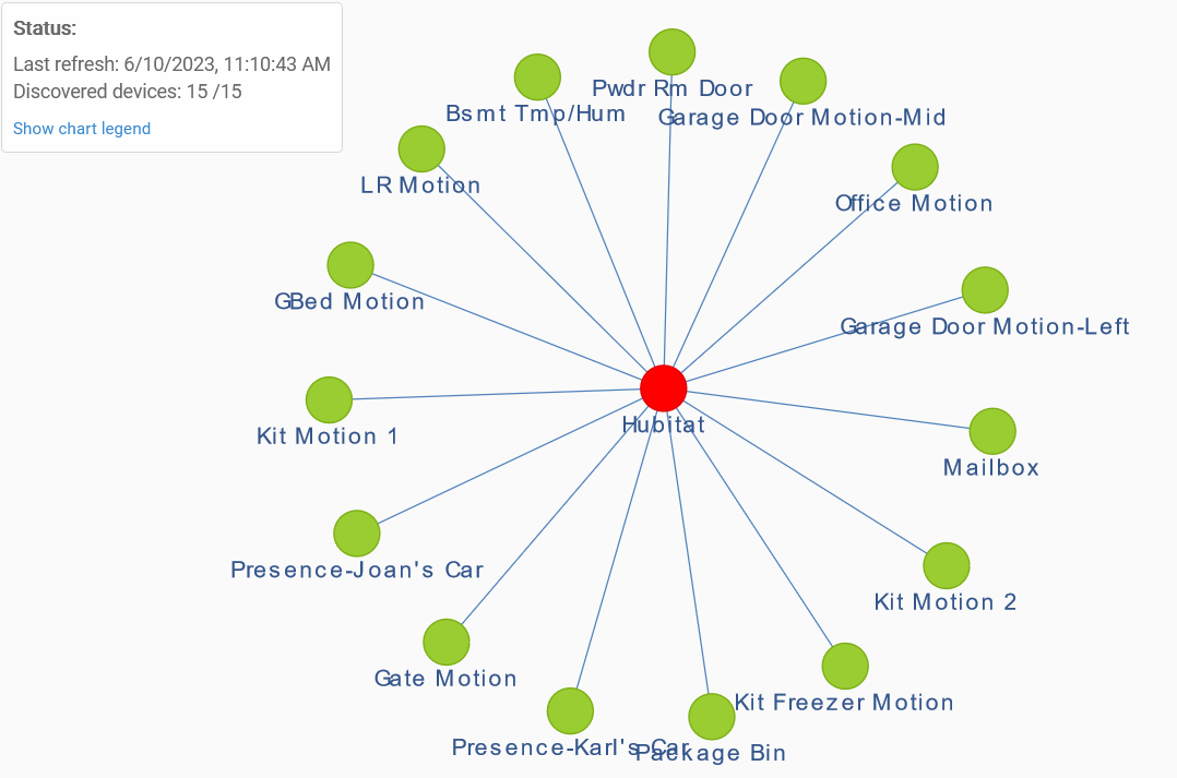

This has been my most stable configuration on C8:
Remember, that's per repeater not an overall device limit
O
I tried to be clear about my question.
Strictly radial arrangement. Battery devices direct to hub.

Heh, not here.. This is a small portion of mine
