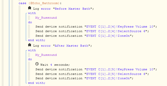

I am finding that I need 4 seconds between zone instructions or one of the zone instructions do not get executed properly.

@Bullfrog, any luck getting consistent results from the driver? Every command I use seems to work perfectly if I am controlling a single zone. I cannot repeatedly get more than one zone to turn on when trying to control multiple zones. HE logs record that the commands are issued correctly and I get the "S" response from the Russound for each command. But 1 of 2 zones generally does not turn on. I have tried inserting a wait to see if commands are going to the Russound too quickly. That does not seem to work repeatedly. I'm not sure what is happening.
I do not have any way of capturing the response from the Russound. The driver that we are using does not currently offer a way to do that. So, essentially, it is still a one-way situation for me. Yes, I can look at the driver in the app and get an idea of what is happening. But as of yet, I cannot use that information in my webcore pistons. And I don't know groovy or anything about writing/modifying a driver.
However, I have been able to use Echo Speaks and Webcore to satisfy all of my needs for controlling my AV/Russound system. So the WAF is creeping upward.
