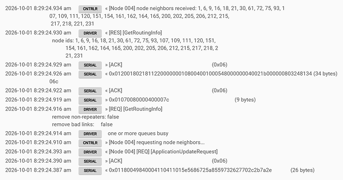

I still have a few of the old GE ZWave Plus toggle dimmers around (14295), which I like for 3 ways since the companion switch has the identical look and feel to the dimmer (using Zooz makes me have a on/off conventional switch as the companion). At some point in the past year, they have all stopped reporting status to Hubitat, or Hubitat has stopped recognizing their status updates. Reincluding them has no impact. I am using Jason's "GE Zwave Plus Dimmer" driver. I have just switched my C-8 to Zwave-JS, and the Zwave log shows the following when turning the switch on:
There is nothing in the logs when I turn it off. I don't recall any setting to turn scene mode on for these switches. Any thoughts?
