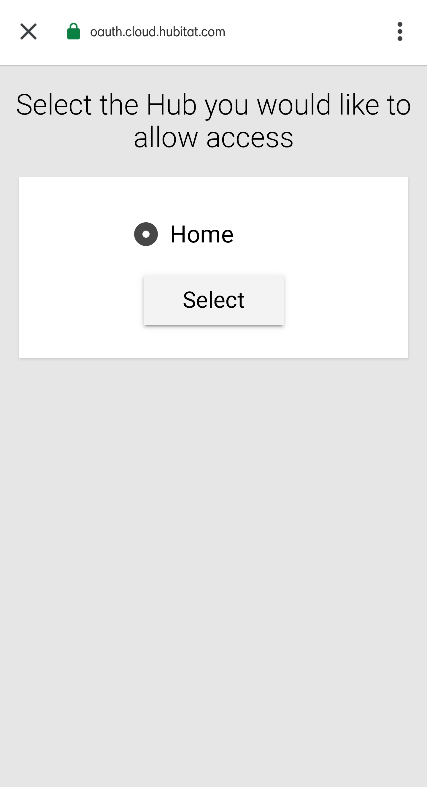

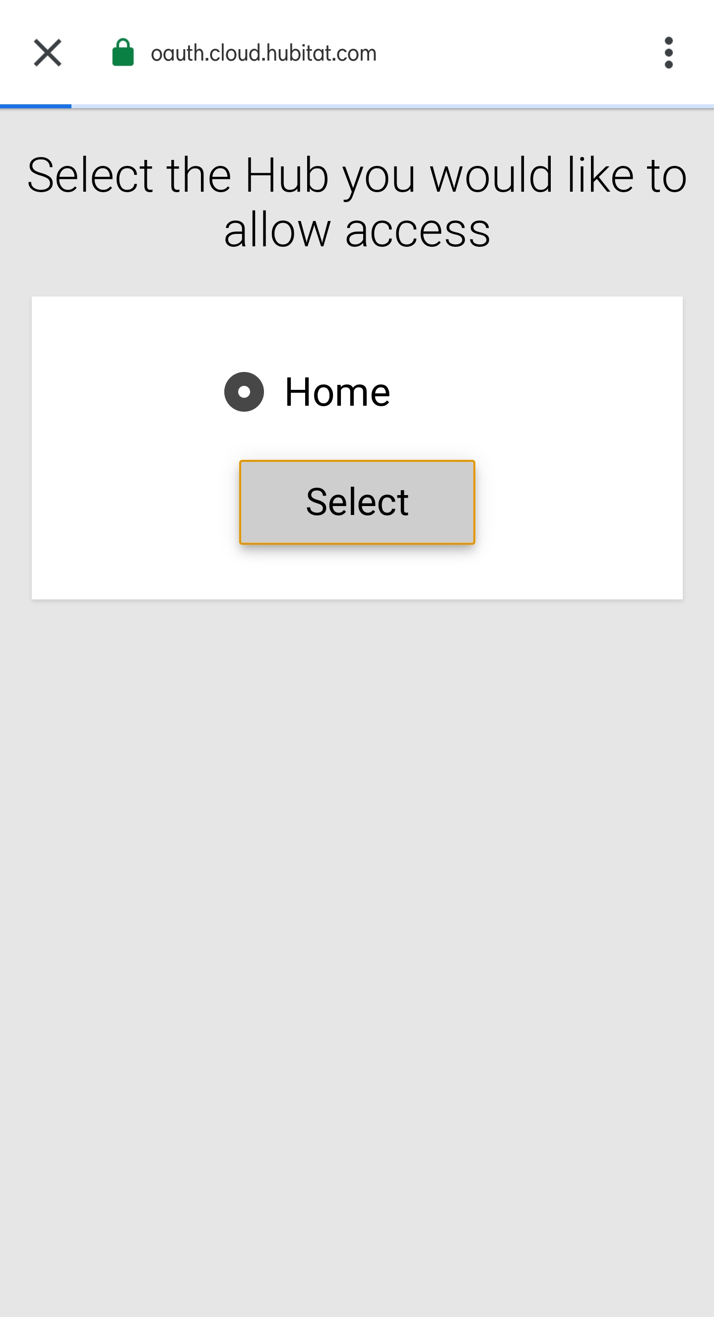

After authorizing all the devices with the Google Home App in Hubitat, I try to connect to Hubitat with Google and get the following error:
The parameter "state" must be set in the query string.
I know this was an issue with one of the earlier firmware versions, but I'm seeing it again tonight. I sign in using my Google credentials, and I'm pretty sure if they were the wrong creds, I wouldn't advance to the page which asks which location I'd like to connect to, as seen in the first screenshot.
I've just updated the firmware, and wasn't having this issue last time I tried this. I've provided a screenshot of my hub info as well. Looking forward to getting this worked out!
