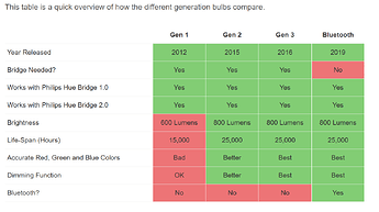

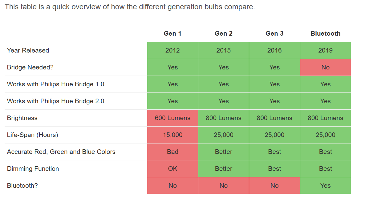

You can check HERE to find out which generation of Hue bridge and bulbs you have.
The latest 4th gen. bulbs with Bluetooth should be ZigBee 3.0 and work with no issues on your Hubitat hub.
Well the hub is a 2nd gen but not sure if the bulbs are the BLU version. Let me google what ver are the BLU kind if not they are going to the FREE pile.
If you have one of them close at hand the easiest way is to check for the Bluetooth symbol on the bulb.
