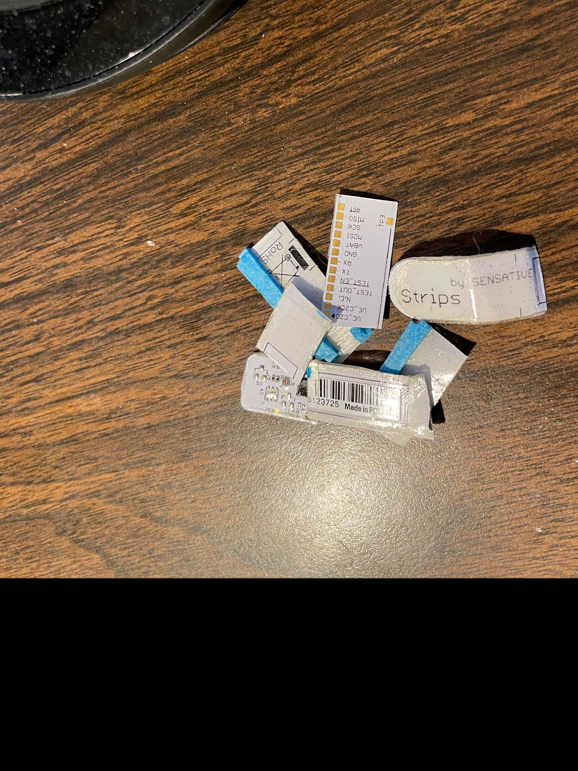

ya those strips are a pain. could never even get mine to pair with the stupid magnets.. threw them all in the trash.. what a waste.
I kinda like them for places that are inconvenient to get to so you dont want to have to be constantly replacing batteries... but this one I just lost patience with. The magnets are a pain though.

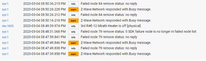

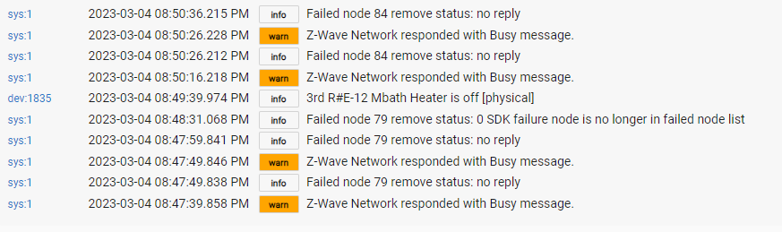

What do you make of these log entries Bobby?
It looks to me that you poured sugar in the gas tank, although the Mythbusters debunked the myth that is the end of the world for your controller.
Jokes aside, your Z-Wave radio is bombarded with messages and you cannot remove the ghosts. How you ended up in this situation is hard to tell. How you get out of it, is even more challenging.
