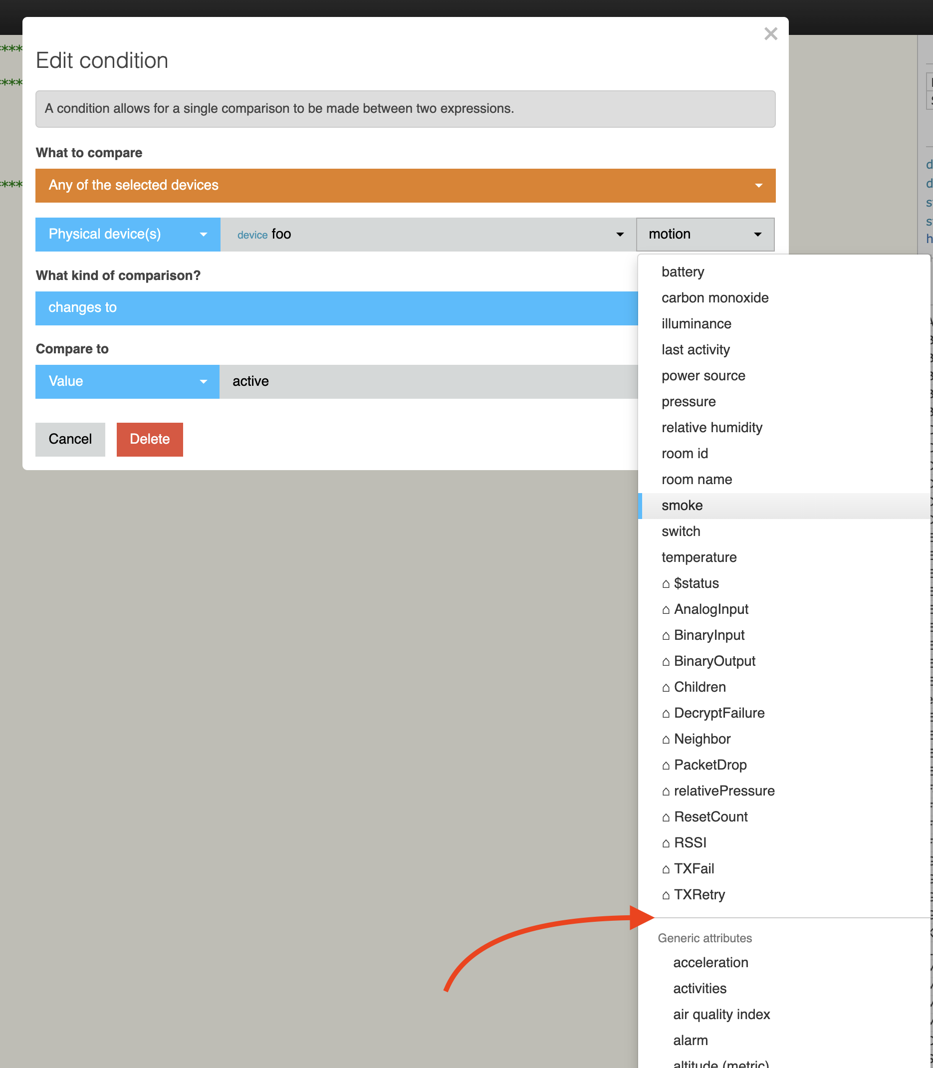

  1. Are there any errors in the browser's dev console, particularly any that recur when opening the condition editor?
  2. Does motion appear above this line or below "Generic attributes" for devMotionDevices?

Finally clicked after staring at your example.
I was picking "If variable compares to" like some nube because it is indeed a variable.
In reality it's really treated as a Device and I forgot to choose Physical (as it's really just a pointer to a list of Physical)) scroll all the way to the bottom of the Device list so see the Device variable name.
So focused on picking the local variable name as that's the one that shows at the top of the list.
Confusing explanation I know.
