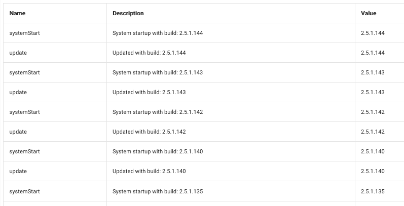

I'm not seeing the same, if my logs are adequate:
The Hub Events shows the SystemStart events, but the Live and Past Logs do not. If the events don't show up in those logs then RM can't use them as triggers.

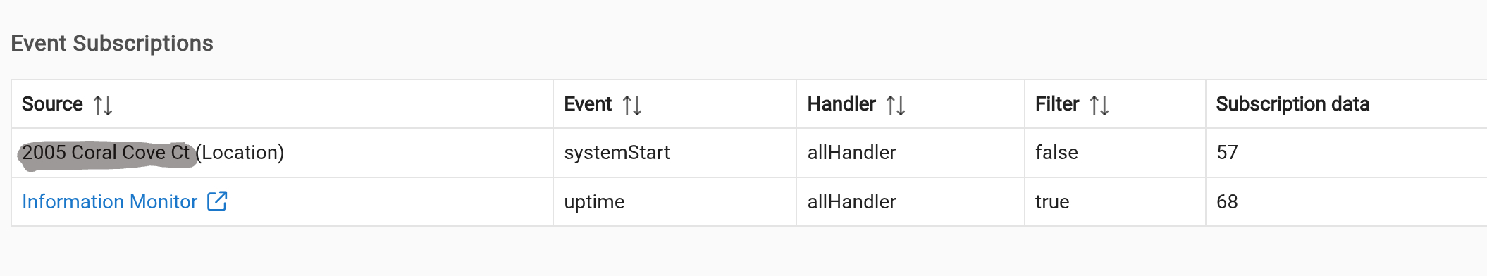

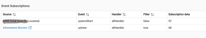

This shouldn't be the case. Apps, including RM, would subscribe to the hub or location event, not scrape data from log text. (So the real question is indeed whether they show up where @csteele indicated.) Can you verify on the App Status page for a problematic app that the subscription is still in tact, or that hitting "Done" doesn't fix it?
The subscriptions are valid. Will try a reboot with Rebuild.
