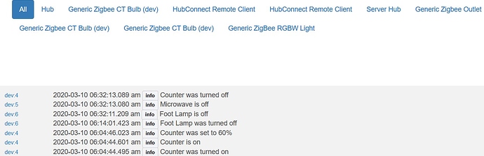

I have a very odd issue that I have yet to find a resolution. On my primary hub, when I look at the log history, I can see the device names listed at the top so I can more easily filter, these are the names I gave them during set up (i.e. Living Room, Hallway, etc). I had to set up a second hub to move my "problematic" Lightify strips/bulbs and on that hub, the log headers show the device type instead of the named device (i.e. Generic ZigBee CT Bulb, etc). But oddly, in the actual log, the device name is shown (i.e. Counter, Microwave, etc) Is there a way for me to get the 2nd hub back to displaying the actual name vs device type in the category header? Any ideas? Thanks!
The logs will display whatever is in the Device Label unless there is nothing in the device label and then it will display the device name. So, if you add a label to those devices in the secondary hub, that is what will be displayed. The name is defaulted to the driver that is selected when you pair the device to the hub.
Thanks. Oddly, I have device labels set up on all devices on the 2nd hub, but only the Device Type shows in the headers on the log. The device labels do show for the detailed logs below the main log header. See below.

As you can see, there really is no difference and device labels appear to be correct. I've rebooted the 2nd hub, and the issue remains in the log.

If there are events in the list from before you changed the name, it's going to use the old name. Eventually it will use the new ones only when old entries are purged from the log.

From day one, the log headers have been wrong on the 2nd hub. This more of an annoyance than anything and odd that it differs from the primary hub where I used the same pairing process for all my devices.
Maybe this is the case … its almost exactly one month ago that I set up the 2nd hub. When I scroll to the very bottom of the log, it looks like where I set up the hub and paired devices for the first time. Maybe I just need to wait awhile longer for the log to get purged/overwritten. I just don't recall seeing this on my primary hub, but it has been awhile since I've paired any new devices to the primary hub and mostly have only been adding more Lutron Dimmers/Picos recently

Good idea … I just tested and while looking at live logs in a 2nd tab, when I power a device on/off, the header does show the correct device label name. I suppose I just need to wait for the past logs to eventually purge and correct themselves. Thanks.
