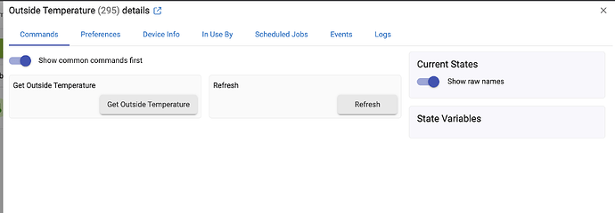

Once you add the driver code, just create a device using the driver to simulate an outside temperature sensor:

I've installed the driver code and added the device, however, when I view my device it does not show the state variables, any fixes for this? I did ensure my location was set in the settings.
I have moved this driver to a different thread here - Open Mateo API-driven outside temperature and humidity sensor
