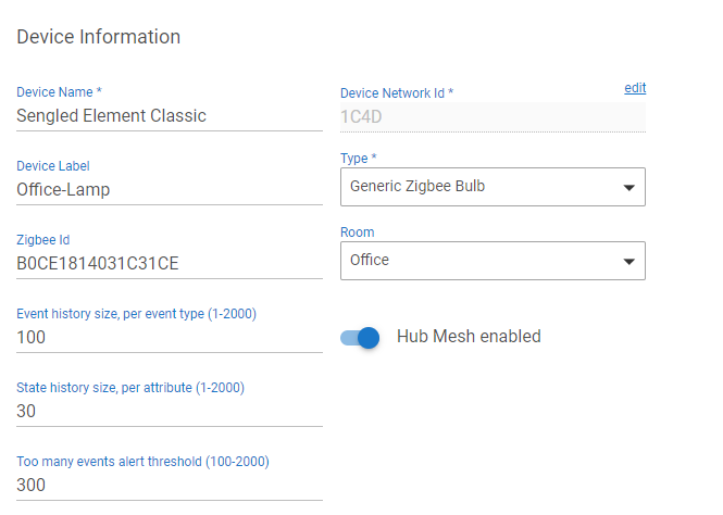

Not a big issue but I am working on some Hub Mesh designs this morning and noticed that when I turn on Hub Mesh on my primary hub and shared my first device which was the Office-Lamp my UPS child device now also shows being shared. Checked on my destination hub and the only device being published is the office lamp. I also checked the devices on the originating hub and it has no option to share.

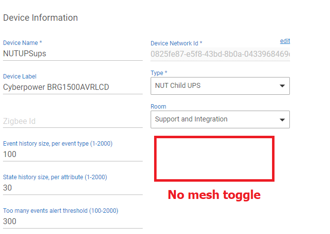

Here is the parent device you can see that the slider is off.
OH well I tired everything, Toggled the mesh for the parent device on and off, removed and reinstalled the device, and still it shows up as a shared device from the parent hub. On the other hub all that shows up is the office lamp. I'll just let this one stew in the land of limbo.
