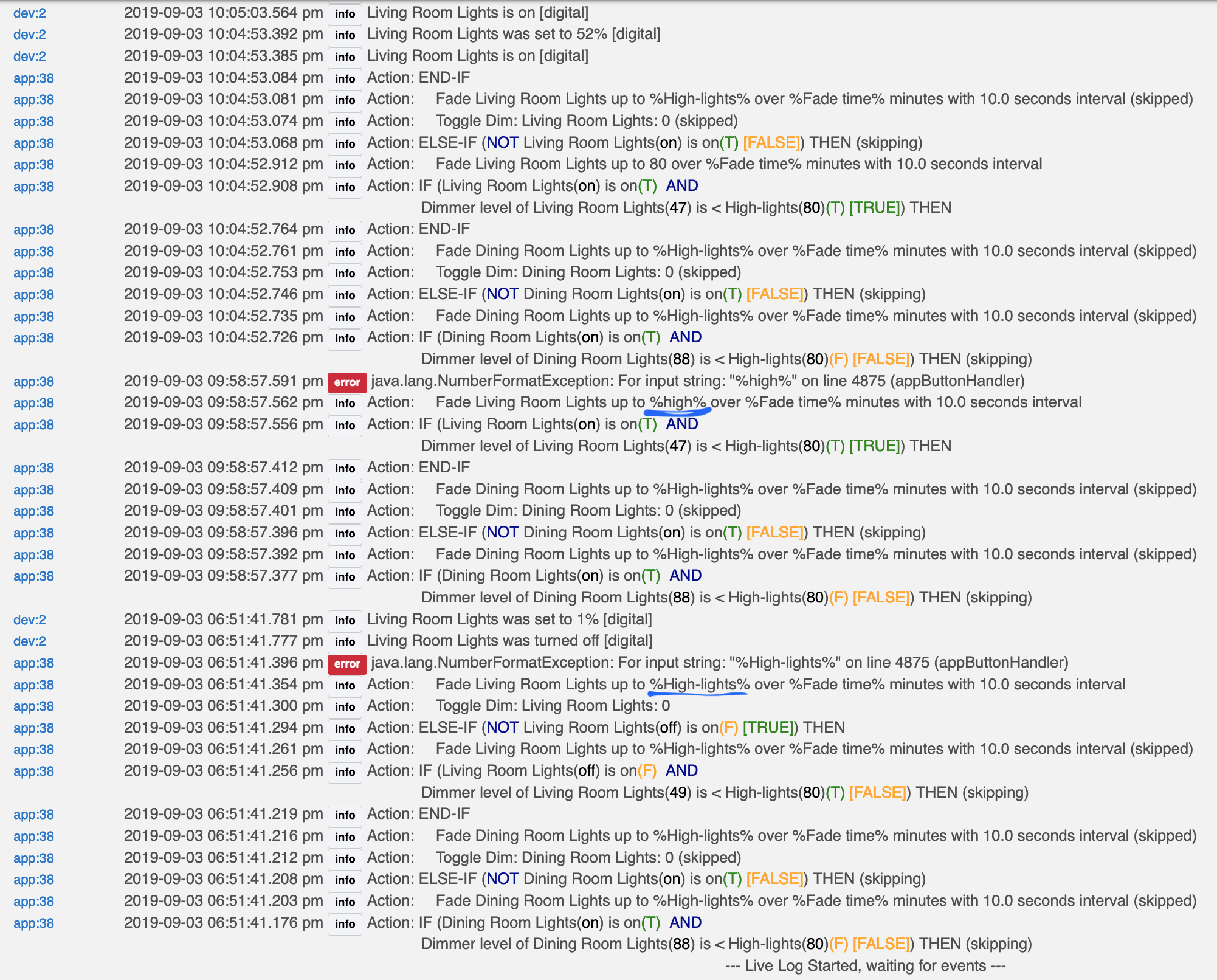

I am trying to use the "Fade dimmer level over time" Action using a variable for the dimmer level to fade towards, but it fails to process the Action, and the logs show the error:
java.lang.NumberFormatException: For input string: "%High-lights%" on line 4875 (appButtonHandler)
The Action works if I use a hard-coded number (80). I've tried using a global variable (named %High-lights%) and a local variable (named %high%) but both suffered the same error. Here is a screenshot of both attempts, then a successful attempt using a hard-coded number:
I'm currently running version 2.1.4.130

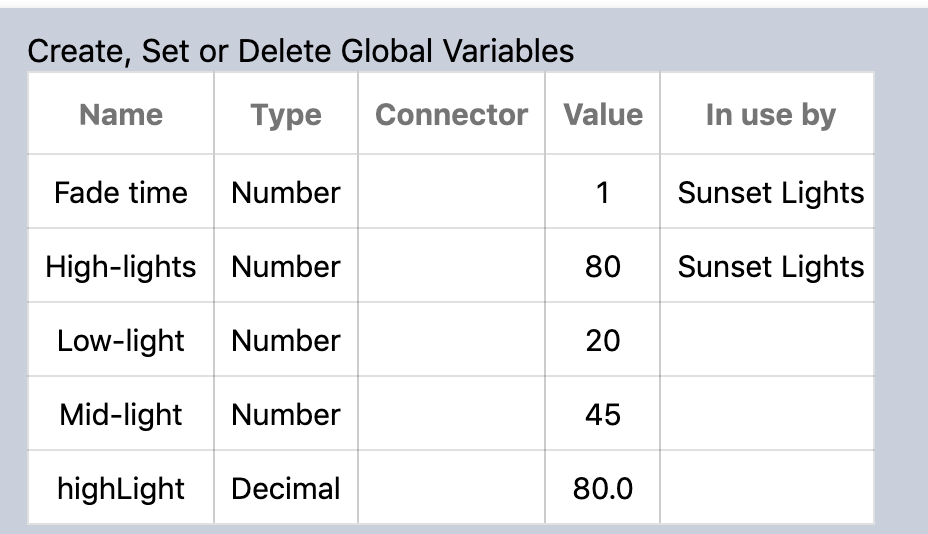

The variables must be of type Number. Post a screen grab of your global variables page?

I'm using the variable inside Rule Machine. Both local and global variables that errored in the logs above are of type number. I also attempted to use a decimal, but it wouldn't save the rule using that decimal variable.
23%20PM
I don't know that the fade over time can use a global variable. But you should definitely take out the "-" and the spaces.
The logs screenshot above show that it also errored on the local variable %high%, and that it ran successfully ran using the %Fade time% variable but hard-coding the dimmer level.
I.e. this failed:
Action: Fade Living Room Lights up to %high% over %Fade time% minutes with 10.0 seconds interval
java.lang.NumberFormatException: For input string: "%high%" on line 4875 (appButtonHandler)
But this succeeded:
Action: Fade Living Room Lights up to 80 over %Fade time% minutes with 10.0 seconds interval
Living Room Lights was set to 52% [digital]
So it looks like there's a bug when trying to parse a number from any variable in the dimmer level slot. Which is weird because when I am creating the Action it definitely checks that the dimmer level variable is valid.
