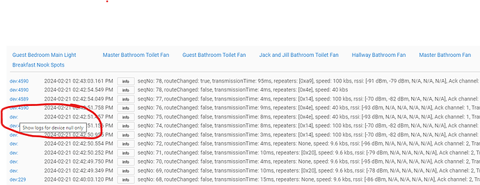

In troubleshooting this I've noticed that some devices in the Z-Wave logs do not have an id:
This feels like a database corruption problem or something related. Any thoughts?

The one without the name is probably the null device in the z-wave logs.
That is a device attached to the z-wave radio but it is not linked to a device in the HE database.
Try a refresh and repair on it, if it works then its a running device. You might be able to attach a virtual device to it again, or you may need to exclude and pair it again to fix it.
If the refresh and repair are failing, then it is what we call a ghost node, and you will want to remove it. However since it shows neighbors attached you would need to use a secondary controller to remove it.
