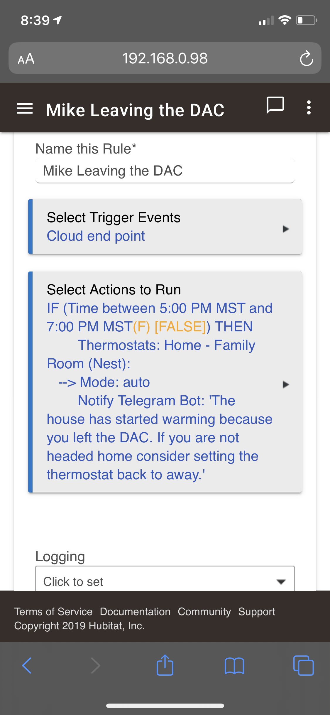

I’m using NST Manager with my Nest thermostat and have the below rule setup to take the thermostat out of eco mode when leaving work. The rule is firing because I get the notification but the thermostat isn’t actually starting to heat. Im sure it’s something simple but it’s alluding me.

I created a headed home mode that should set nest to home but for whatever reason that’s not working. I’m a little hesitant to mess with nst manager as I don’t want to break the entire thing.

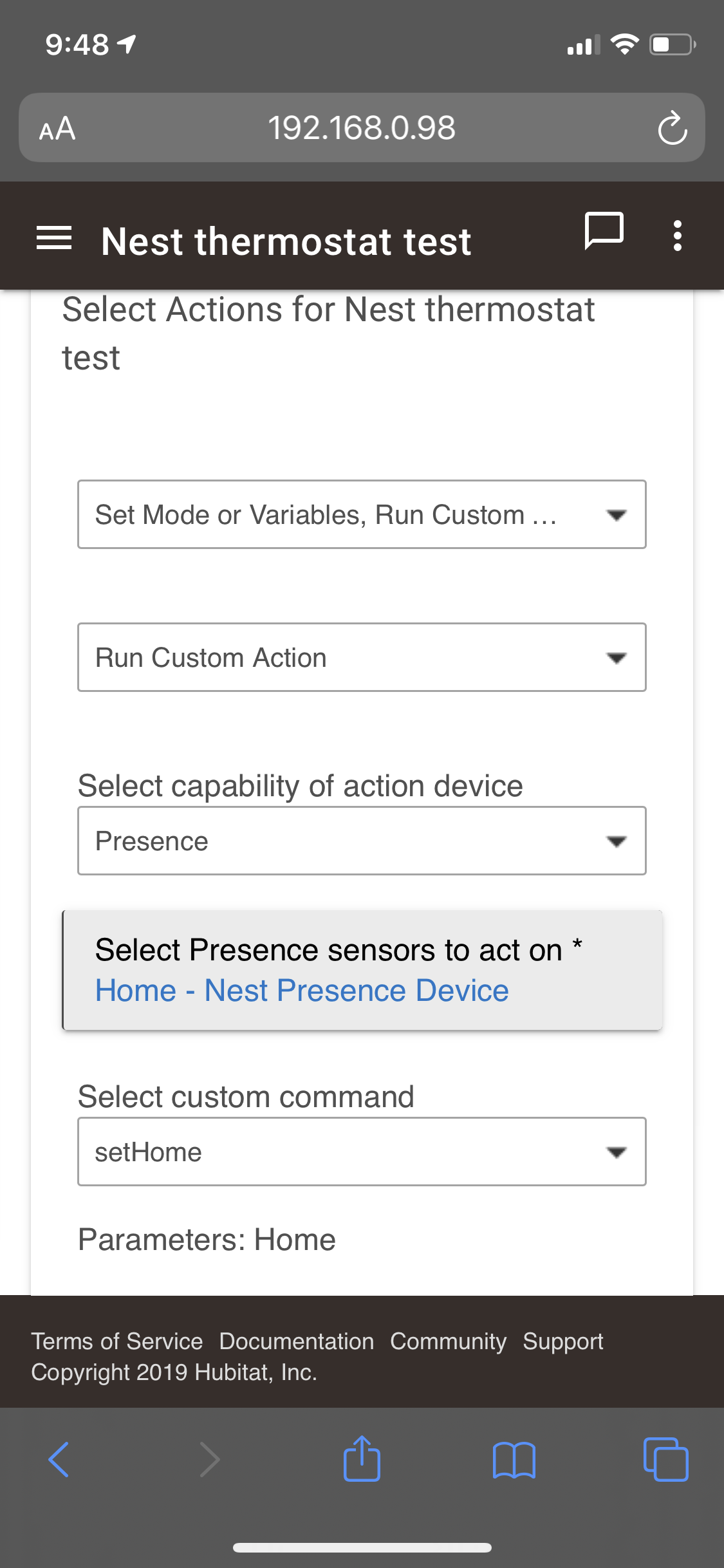

Could I use a custom action in rule machine to set nest to home mode?
Yes that's what I do, works perfectly.
Sorry for the long wait, should this work?
Yes that's it :grinning:. No parameters needed.
I have this setup and nst Manager reflects an home status but the nest app never updates to reflect Home.
