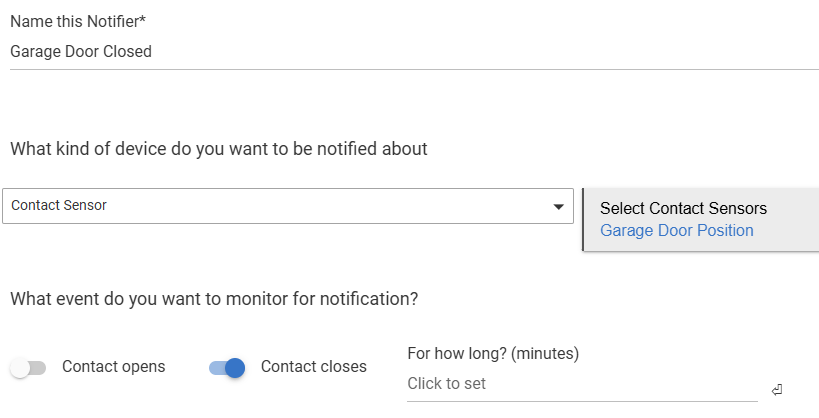

From what I can tell, the Notifier App feature to add a delay on an event (For How Long?) only allows a "minute" setting. I'd like to use "seconds" for most of my delays. I can do this in Basic Rules, but I would like to keep all notifications in the Notifier App if possible. Am I missing something, or is a there a chance this could be changed?

Sure. For any contact closure, I like to have a little debounce delay. I have seen when my garage door position switch might make, break, and then remake within a couple of seconds. I have a gate switch that I believe could have the same issue. So I would prefer to have a 3 second delay on these cases.

Yeah, I tried, but no go. The field will not take a decimal.

The Notifier App asks "What Event do you want to monitor for notification?". So it is a trigger and it does have a delay option on that trigger. It is just is limited to minutes. Would that be a difficult change to make that seconds? Or minutes and seconds, like other apps allow?

There are other built in app that have a minutes box and I am able to put in 0.5 for 30 seconds, so it seems like it should be a pretty easy fix for Hubitat to just allow decimal values in that input box.
Not doing features enhancements for Notifier at this time, "pretty easy fix" or not. This use case is easily done in Rule Machine. We aren't planning to enhance simple apps like Notifier with RM features, when you can just use a rule to do the automation. That's why RM exists.
