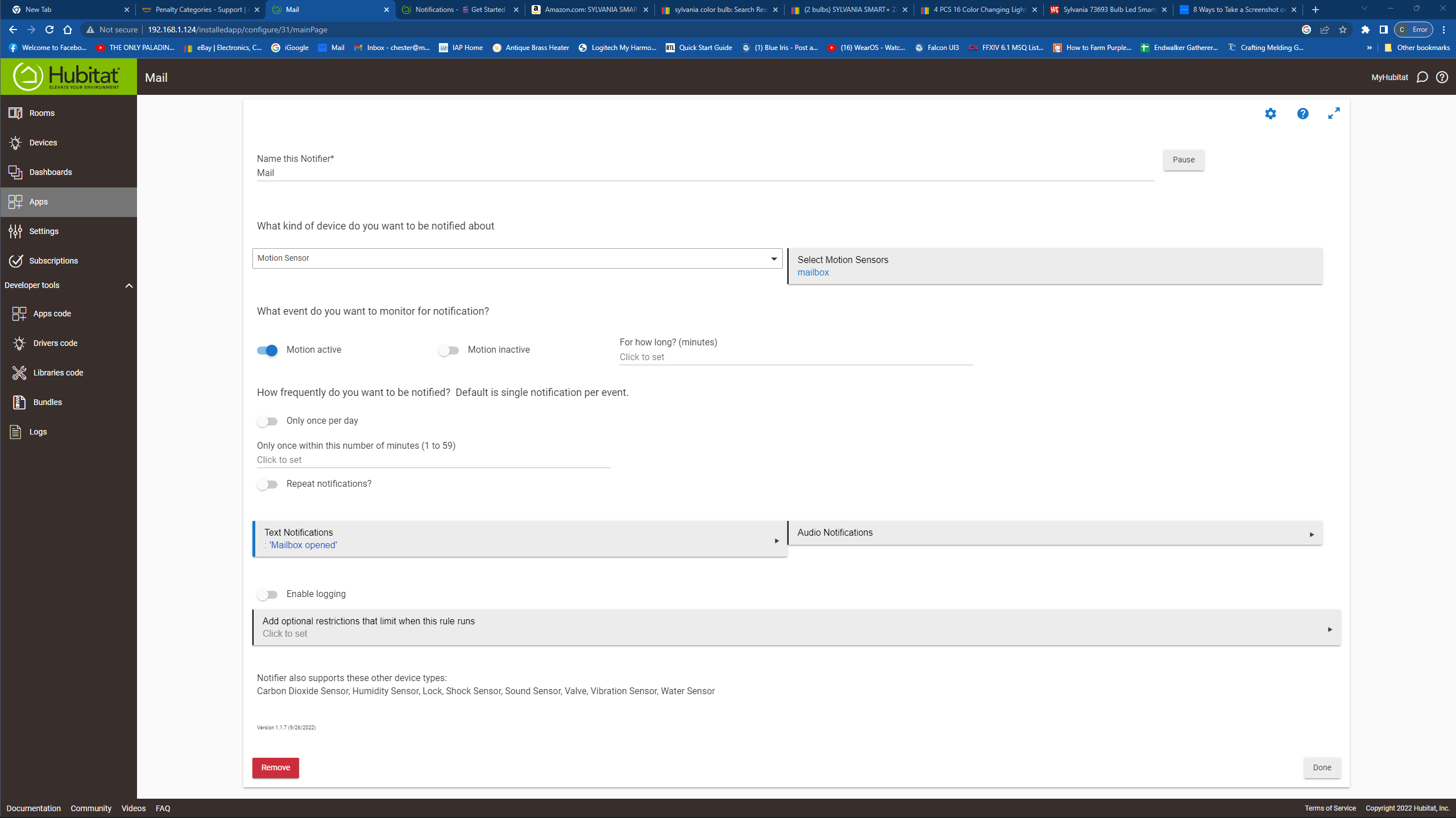

i have a motion sensor set up to send a notification to my phone. on my phone if i go to notifications i just get a spinning wheel nothing else. what am i missing?
Can you post a screenshot of your automation? Which app are you using for notification?

Maybe I'm missing something but it doesn't look like you have a device specified that is supposed to receive the text "Mailbox Opened".
When you select "Text Notifications" the next pop up gives you a dialog box to type in your message, directly above that box (might be slightly different in a browser) is a drop down menu where you need to select your device that is supposed to receive the notification.

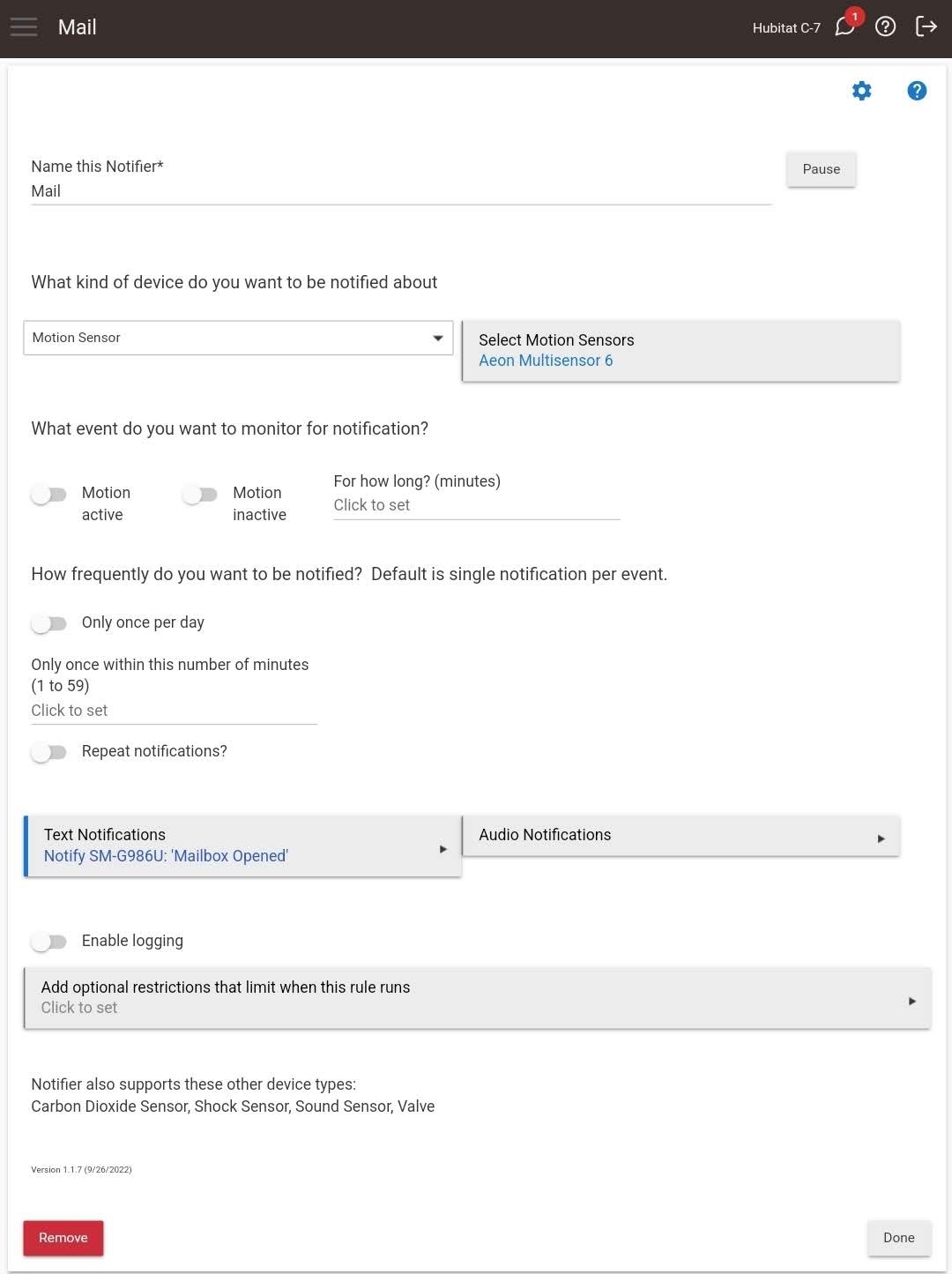

Have you modified that rule since you posted the screen shot because if you haven't then the device is definitely not selected. Should look something like this

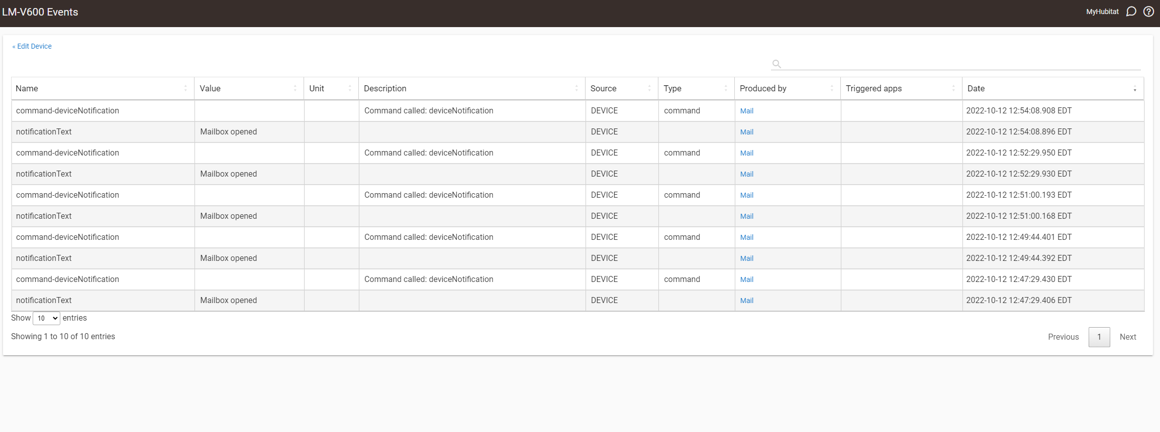

and if i look at the event log for devices-lm-v600 i see what appears to be it receiving the notification but that is a really clunky way to see a notification
