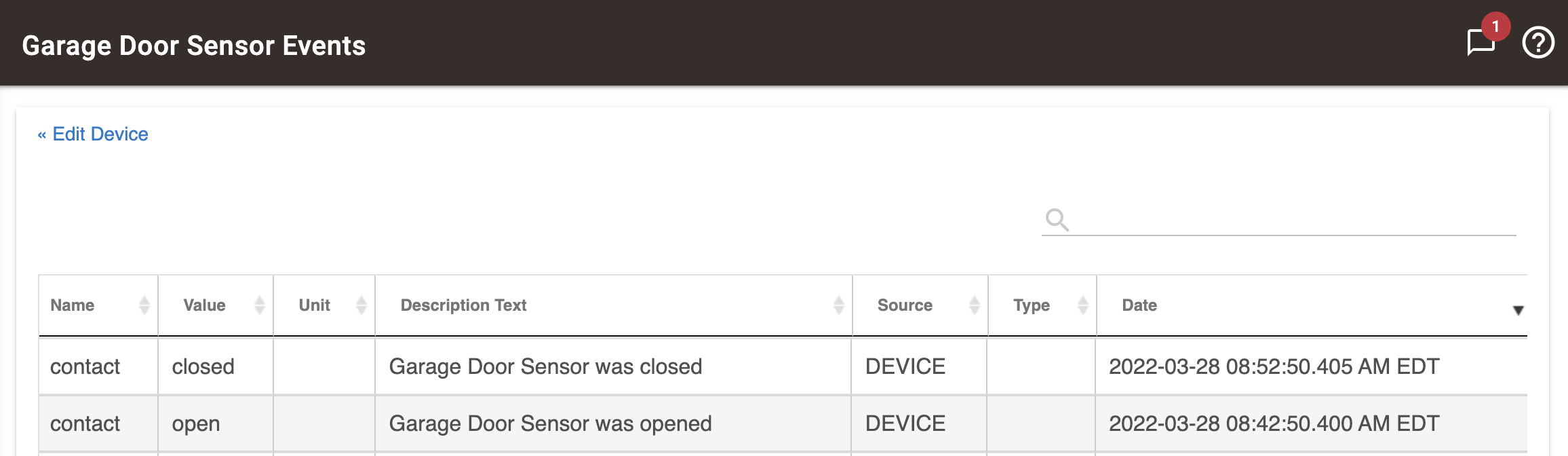

  1. Our garage door was opened this morning at 8:42:50.400 AM EDT.
  2. Our garage door was closed this morning at 8:52.50.405 AM EDT.
Yes you read that correctly. We managed to have the garage door sensor open and close exactly 10 minutes and 5 milliseconds apart as you can see below.

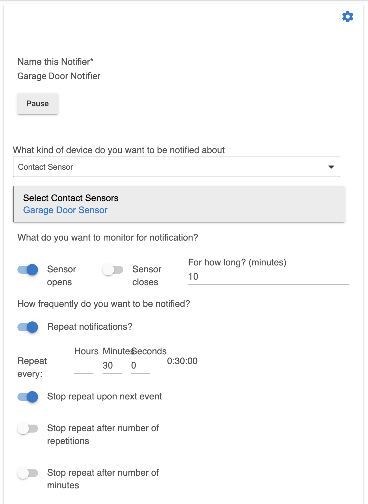

Turns out that we have the notification for the garage door configured to fire 10 minutes after it is opened and not closed.

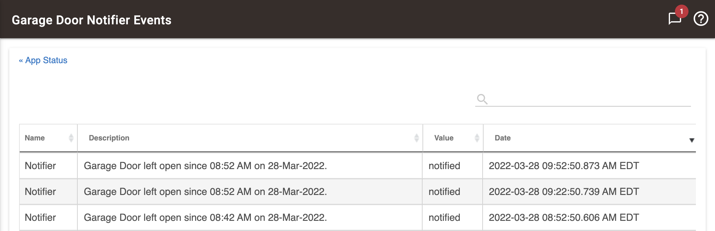

Of course the notification that it was open fired about 200 milliseconds later. Also note how the notification description changed the event time from "8:42 AM" to "8:52 AM".

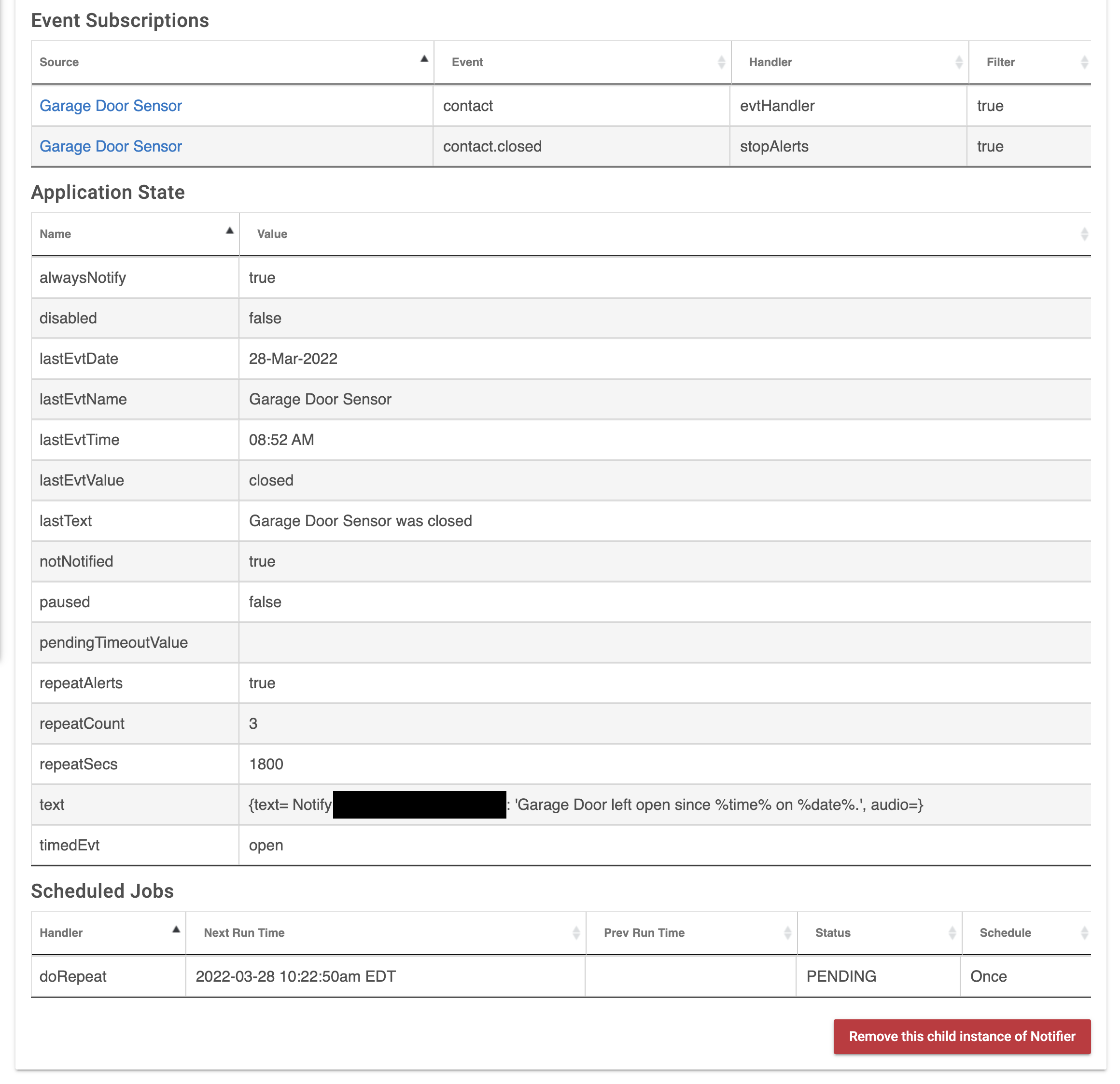

The problem being as you can see above that it then fired again 30 minutes later and still 30 minutes after that. The notifications fired even though state of the notification showed that the last event received was the close event which should prevent the notifications from firing.

Maybe a more straightforward idea would be to check the state of the world right before a notification is fired and recognize when things aren't right. Looking at my screenshot the application state clearly knows that the lastEvtValue is closed. Maybe the notification routine should be taking that into account and canceling the notifications and reseting the state in that instance?

I will take a look at this. I suspect it's a multiple simultaneous instance problem involving application state. That can probably be overcome. Don't know how to test it, given the very specific timing required for it to fail.
There is indeed a critical state variable involved with this. I believe the fix is to commit that to atomic state, so that separate app instances are effectively serialized with respect to reading and writing that variable.
