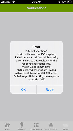

This is the error message in the iPhone notifications tab:
Error
["KotlinException":
io.ktor.utils.io.errors.lOException:
Failed network call from Hubitat API; error: Failed to get Hubitat API; the response has code: 403,
"NSLocalizedDescription": Failed network call from Hubitat API; error:
"KotlinExceptionOrigin": ]
I am having similar issue. New mobile app on my iPad shows no Notification in the mobile app while the old mobile app on my iPhone shows Notifications on the old mobile app.
I had had received the same error on my iPad. I thought it was possibly a corrupted database. I rebooted the hub with a database rebuild. Error disappeared but nothing shows in Notifications on the new mobile app.
The API error is intermittent. My mobile phone never receives a notification, although the ipad and other iPhone do. Most frustrating. I hope one of the gurus can tell us the solution.

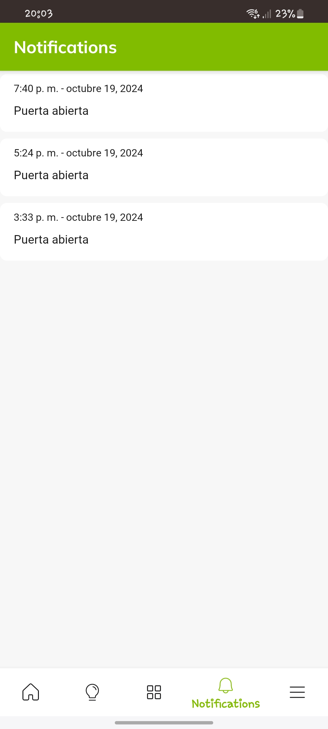

Hello friends, I still have the same problem, the notifications appear but only 3, the others do not appear, does anyone have the same problem?
Log out of the hubitat on ALL devices. Go into hubitat itself and delete ALL notification devices. (Do not miss any). Log back into hubitat with the app (only one app, not old and new) and let it create a new notification device. Change your rules to reflect the new notification device.
But what does all that have to do with it? The problem is that in the app I only get 3 notifications, I don't get any more. I get all the notifications on my phone but when I enter the app I only get 3
