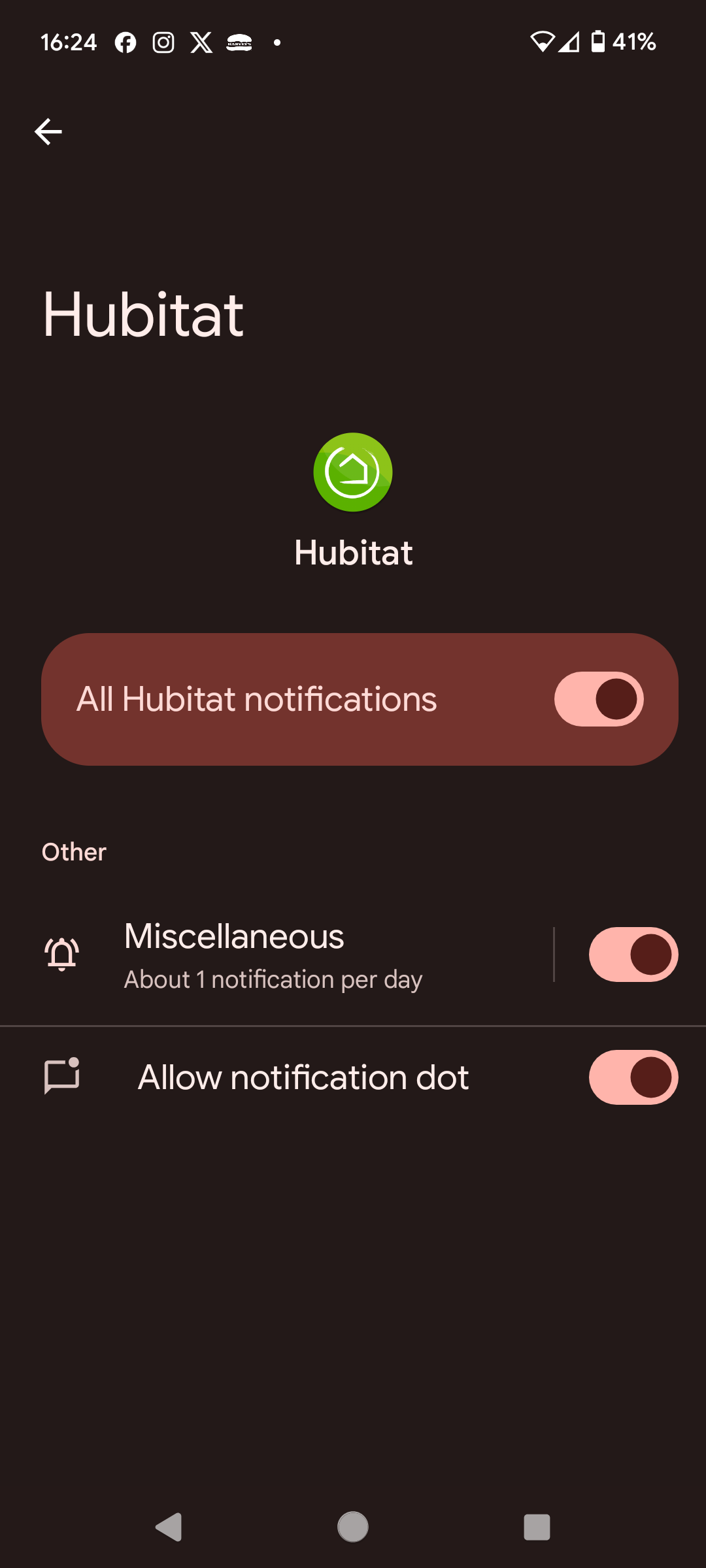

But on my phone, the notifications appear to be on?

OK, I'm now getting notifications, silent for some reason, even though my notification volume is set to max. I'll work on that. So is the next step to swap apps?

Jeff, my notifications are working now. I had to change my default notification sound in my phone to get the sound to work. I think a recent phone update might have messed that up. Thanks so much to you and Bobby for your help with this.
