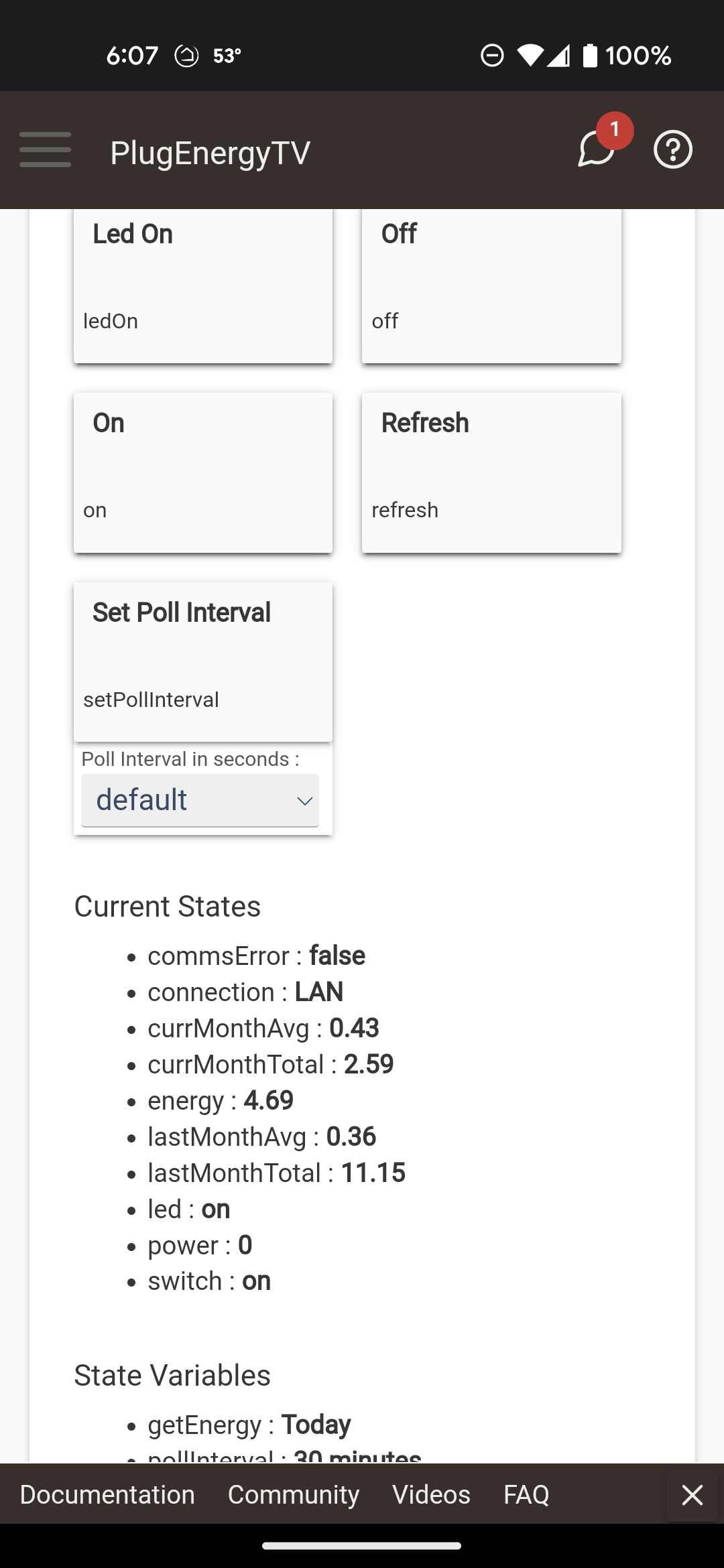

Hi - I'm using some Kasa energy plugs and can't have them turn off (a freezer to monitor energy, my TV to detect on/off state). So I use Notifications to tell me if any plug has been mistakenly turned off for more than 15 minutes.
One got turned off mistakenly last night via Alexa. I got notified. However I continue to get notifications now after 12hrs. Any thoughts?
I thought it is implied that repeat notifications would be stopped once the condition clears? Or am I misinterpreting the settings?
I basically want to be pestered until I fix the condition (within reason).
You need to enable the "Stop repeat upon next event" option (shown as disabled in your last screenshot).
