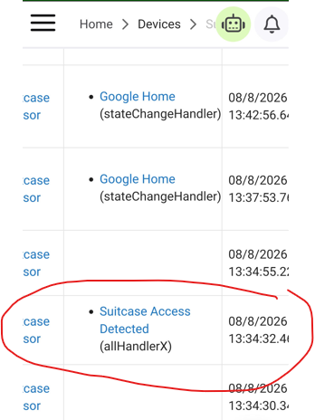

I've noticed what appears to be delayed push notifications, arriving in a batch right when my hub restarts (C-8, v2.5.1.140) - anyone else seen this?
Eg: A motion sensor tripped at 1:34pm Saturday, which triggered a push notification and speech notification from one of my apps. That notification didn't actually show up on my phone or speaker until 1:55am Sunday morning, about 12 hours later, and it landed shortly a hub restart.
I have seen similar on other recent restarts where where a number of aged notifications play out in sequence - almost like a queue being flushed on restart.
Has anyone else run into this? Also curious if there's any way to actually see notifications queued rather than discovering it on a reboot.
See below - the 01:56 notification is a post startup automation, so the actual start time would be a few minutes earlier. The circled event and notification are directly related, just ~12hours apart and other notifications flowed as expected over this time.
Any ideas?
