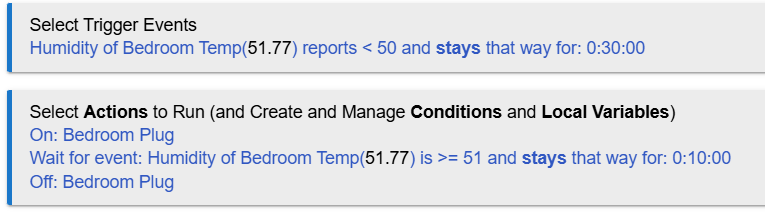

You could use "and stays that way" in the trigger
Same theory, but opposite reason. Humidifier gets turned on when humidity is low so the cat doesn't shock me in my sleep. :zap:

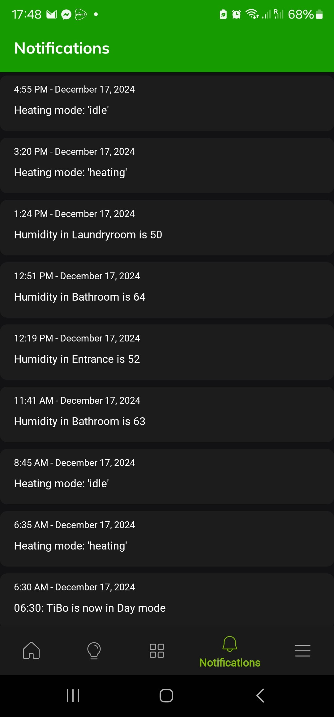

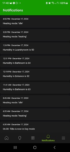

Am i making some mistake? I keep getting notifications for humidity values that are lower than 60. Here some screenshots of the rule and notifications:
Yes. Either create an average sensor and create a notification rule for it. Or setup individual notification rules for each of your humidity sensors.
