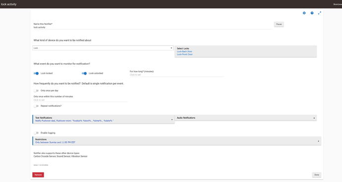

Notification doesn't pick Lock Code Manager data. I added a new code to he Lock Code Manager, when I try creating a Notification for the new code it doesn't show the name there so I can not select it. How do I fix that?
@user4602 No it picks the lock data not LCM. LCM is simply for entering codes or schedules. Your notification format should look like below...
@user4602 Or if you're trying to do things on a specific lock code. (Such as one code turns on lights, but another turns on lights and music, and another turns on lights, and tv but closes garage)
