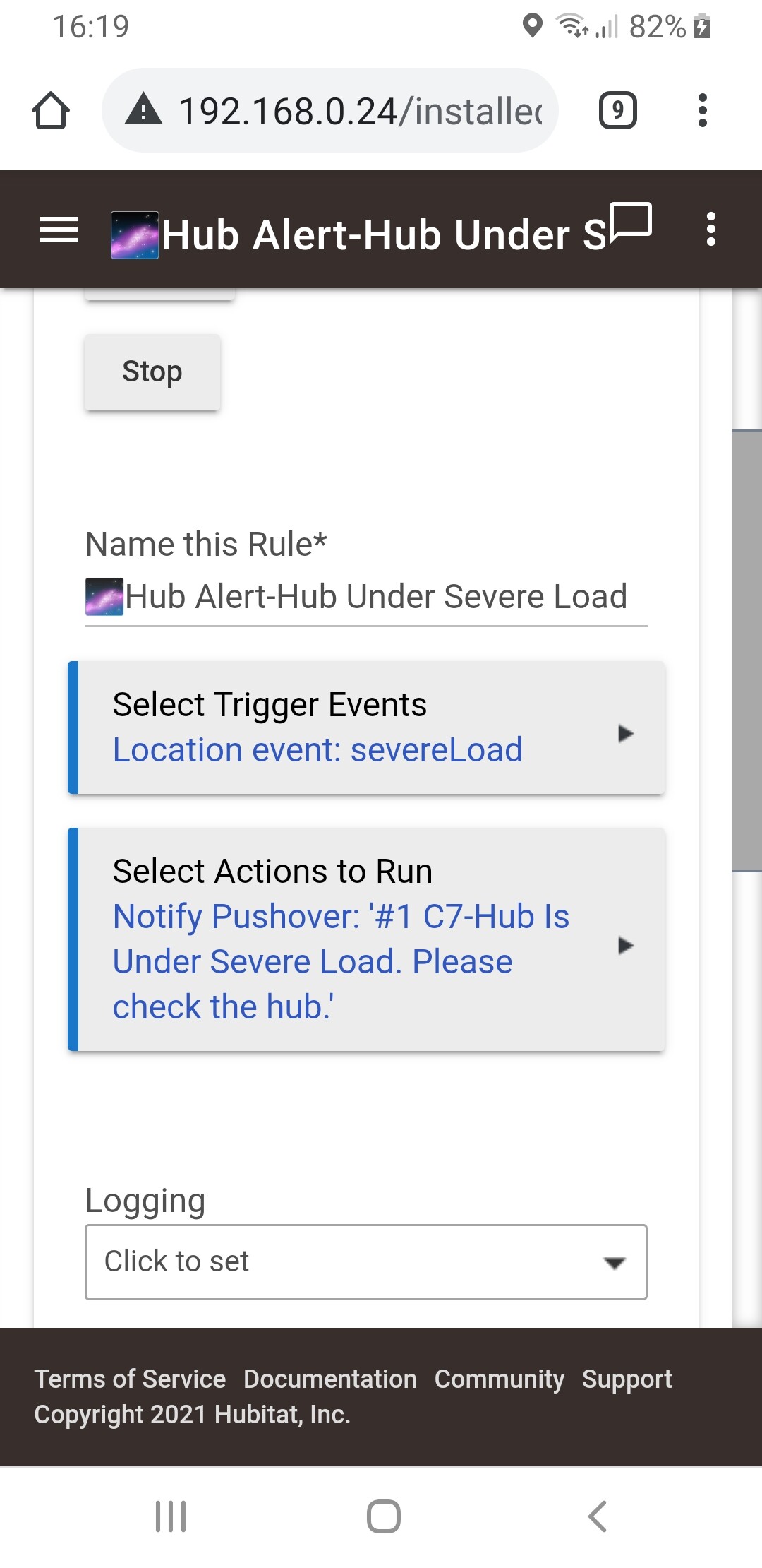

This is what I have.
4 rules.
1 for severe load.
1 for zigbee radio offline
1 for zigbee radio online
1 for z wave radio crash
Perfect, thank you. I didn't think to look under location for the event! Thanks!
