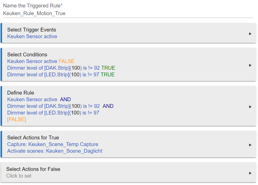

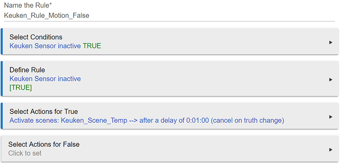

Thank you, thank you, thank you!!! I've used dimmer values for two lights to minimize the chances of accidentally making a scene with the same values.
I just have one more question: will the false (second) rule not be running all day, every day? Is that a bad thing? Should I make the second rule a triggered rule as well?
