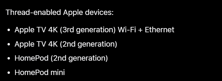

Just to be clear to others who may not be familiar with which models of Apple TV 4K have Thread...
  • Apple TV 4K (1st Edition) - released in 2017 - do NOT support Thread
  • Apple TV 4K (2nd Edition) - released in 2021 - all models support Thread
  • Apple TV 4K (3rd Edition) released in 2022 - WiFi only/64GB model does NOT support Thread
  • Apple TV 4K (3rd Edition) released in 2022 - Ethernet+WiFi/128GB model does support Thread
Summary from Apple

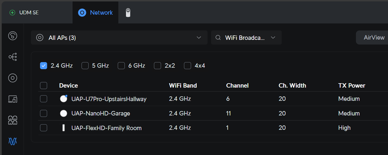

Sure! Just like all home WiFi systems, care must be taken to ensure there is some free RF air space for Zigbee and Thread devices to be able to communicate without being interfered with by 2.4GHz WiFi signals. It is considered a best practice to make sure that all of your 2.4GHz WiFi Access Points are configured to only use channels 1, 6, and/or 11 with a 20MHz channel width. This provides some clear space for Zigbee/Thread to operate in as shown below.

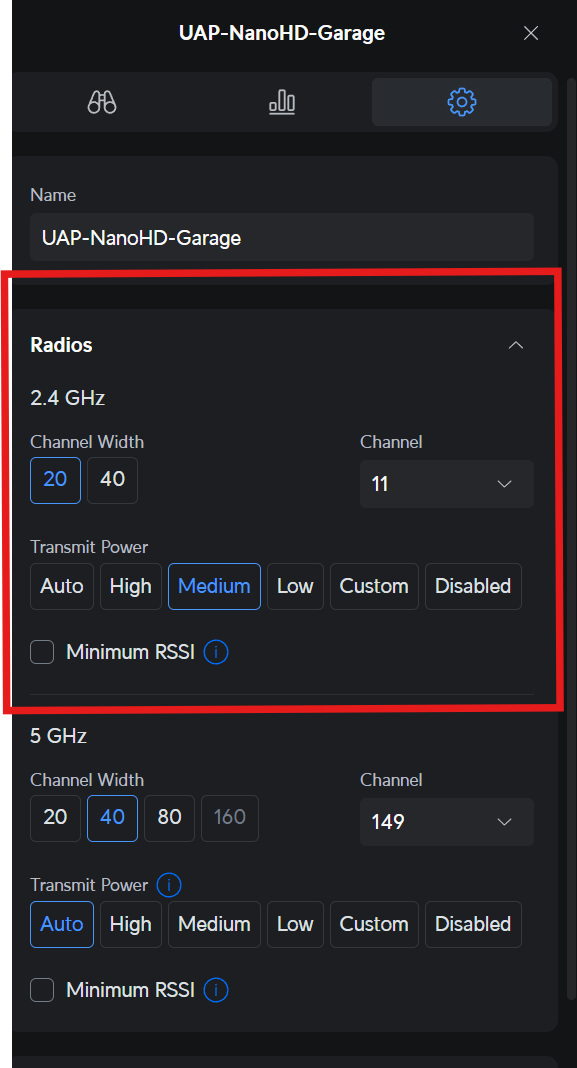

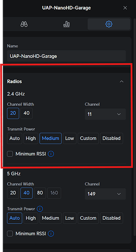

As for the settings specific to UniFi APs, here is how my 2.4GHz radios are configured in my home.
It is best to disable UniFi's automatic channel optimization, as it will probably just change the channel and stomp all over your Zigbee/Thread mesh networks.
Here is an example of one of my AP's radio settings
