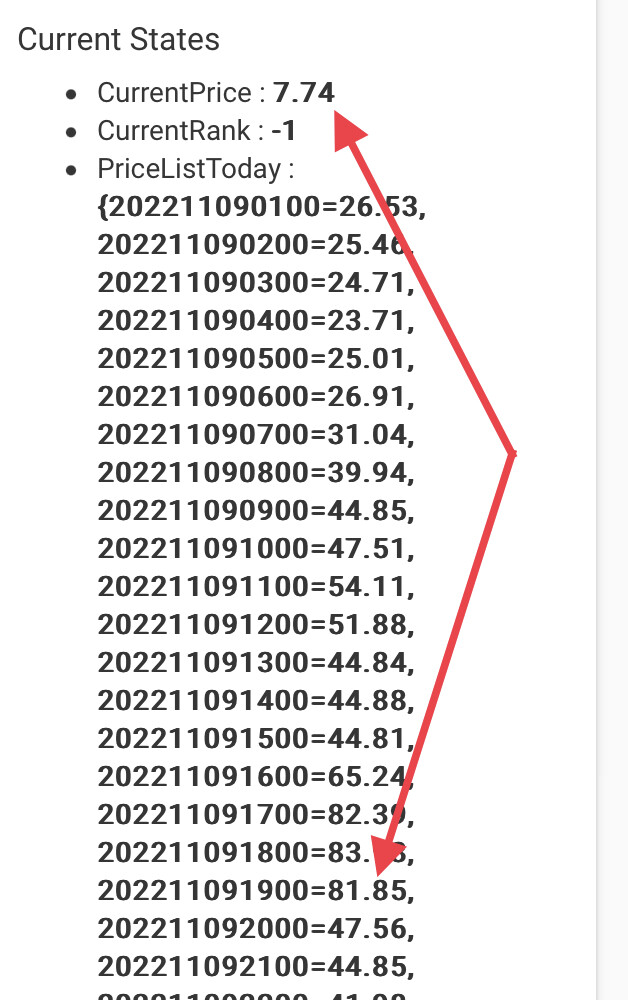

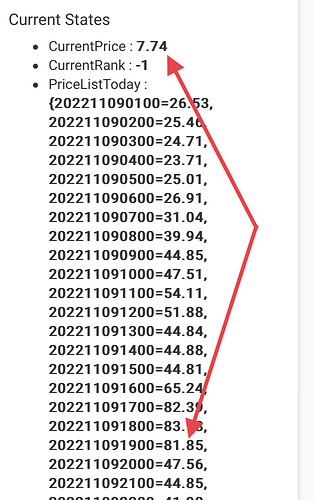

I have just installed the driver and it seems to work except the rank shows -1.
Is that right or do I have to do something else to get I working?
Also, current price dosnt seem to change when using a factor.
Seems to be a bug on the price calculation when using currencyfactor <> 1. I try to find time to fix this during the weekend.
If someone else has time before that, the bug is most likely where the currentprice is calculated (currencyfactor is not included)
Kari

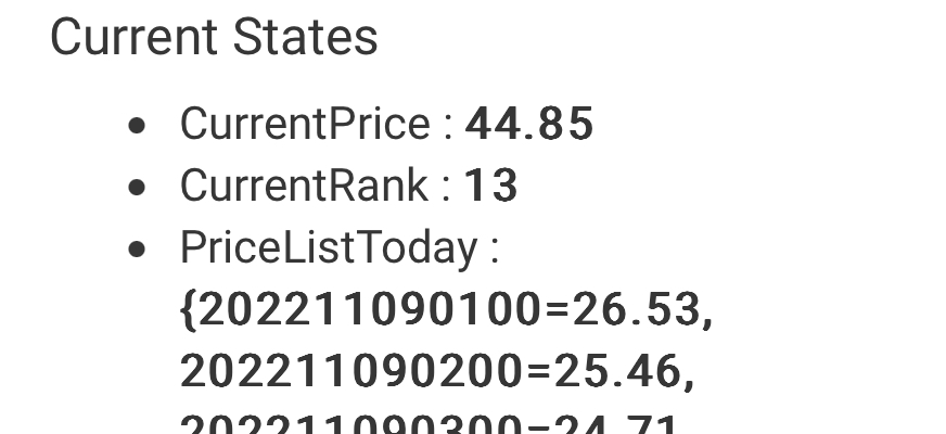

It looks like now should be RANK 11 with price 20.55 (RANK 9 at 20:00). Could it be that price is GMT+3 like I have done, but RANK is from different GMT?
Seems to work now. Maybe it needed some time to adjust. :slight_smile:

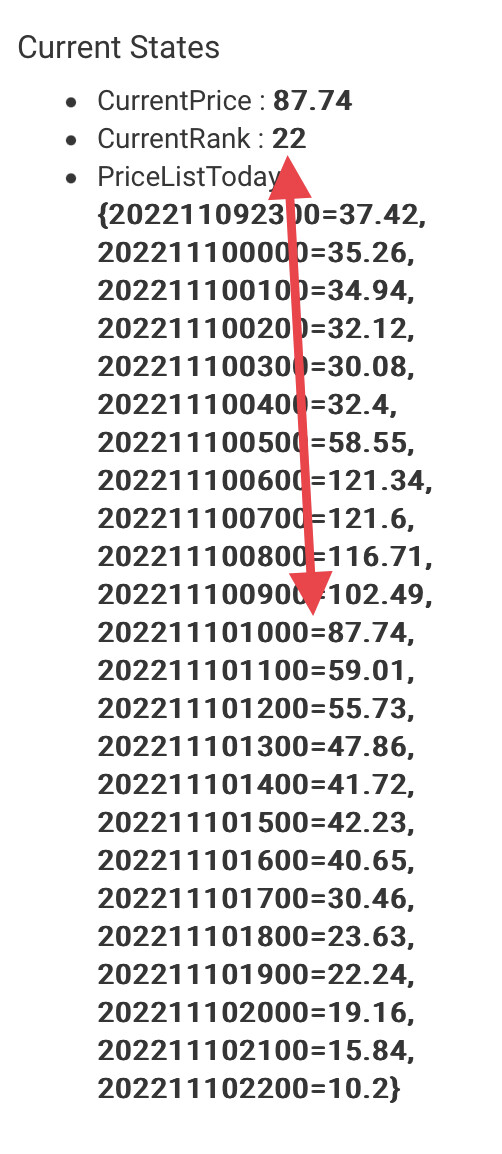

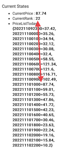

@karipk Something seems odd regarding the ranking. Right now I get rank 22 but to me, it should be 20.
The ranking seems to be totally broken.
HashMap<String, String> rank = new HashMap<String, String>() -> string comparison rather than numeric. I'm afraid I cannot fix this today.
