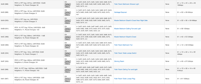

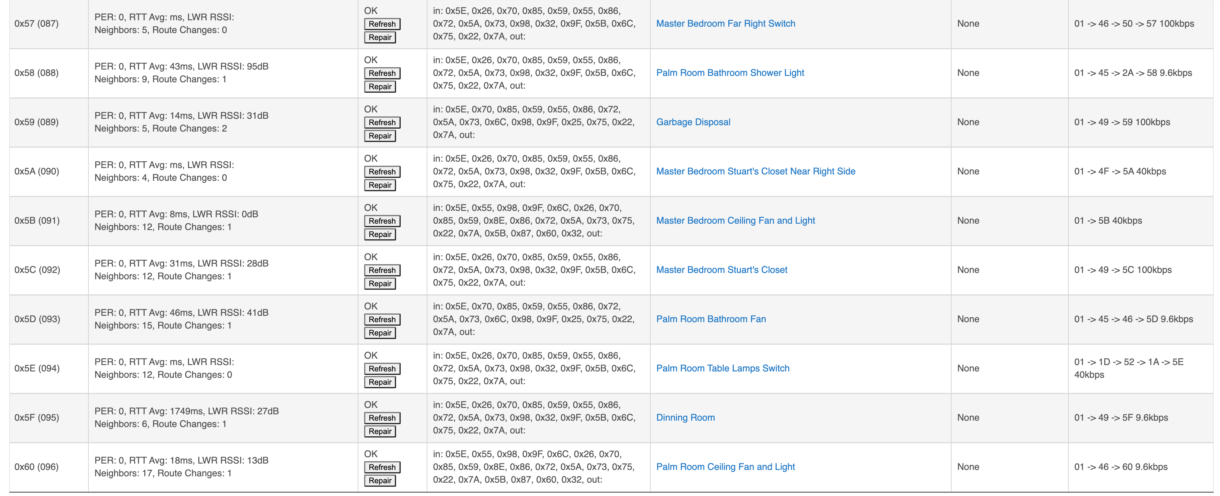

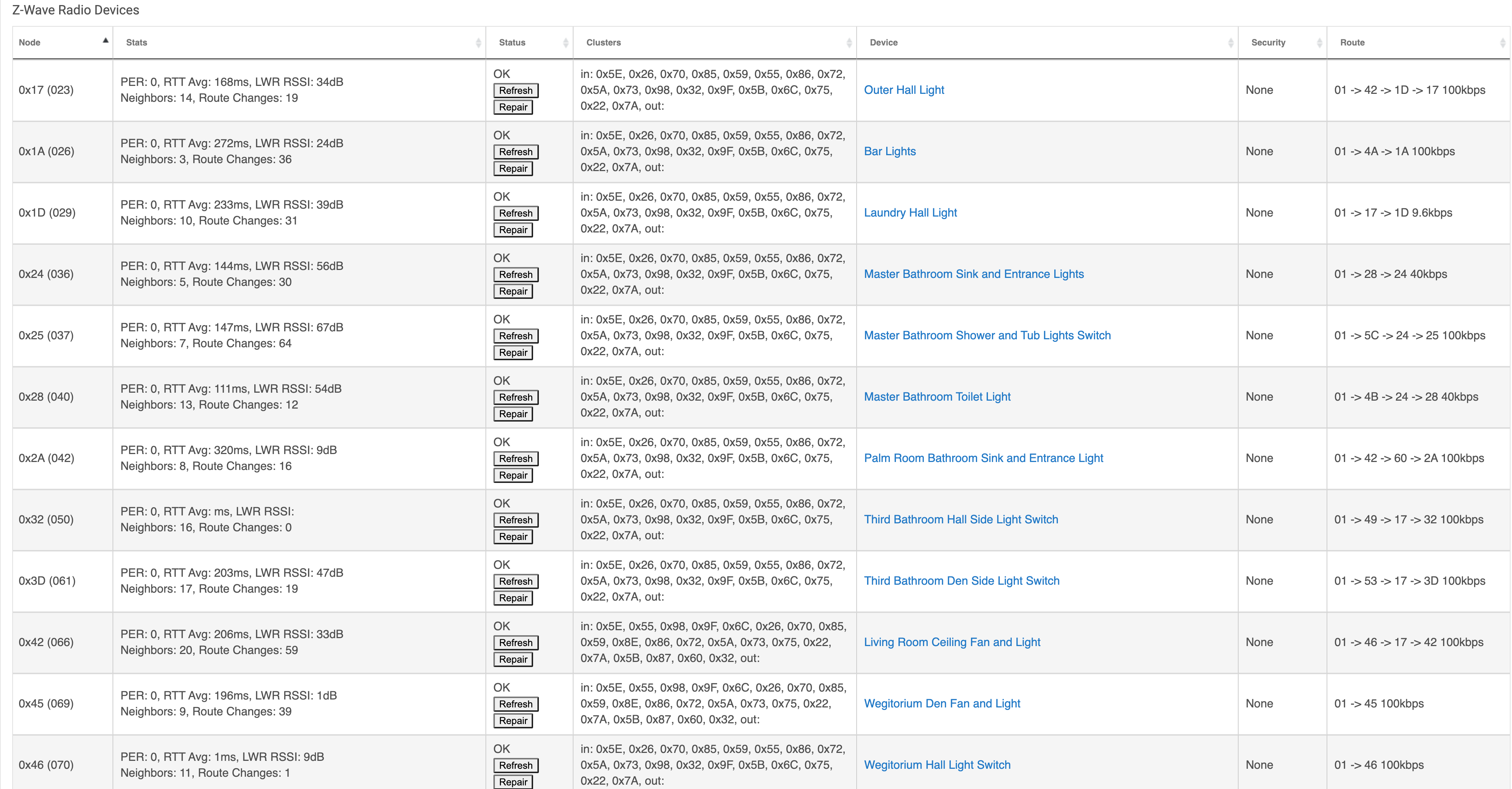

Here is my current Z-Wave table:
The only thing that stands out is the LWR RSSI relative to your other devices for the Palm Room Table Lamp plug.
Overall though much better that I usually see with this problem. No clusters not populated and everything has routes, although you have several devices that are using a lot of devices to route. What does your home layout look like? Anything difficult to penetrate like concrete walls or an excessive amount of tile backsplashes?

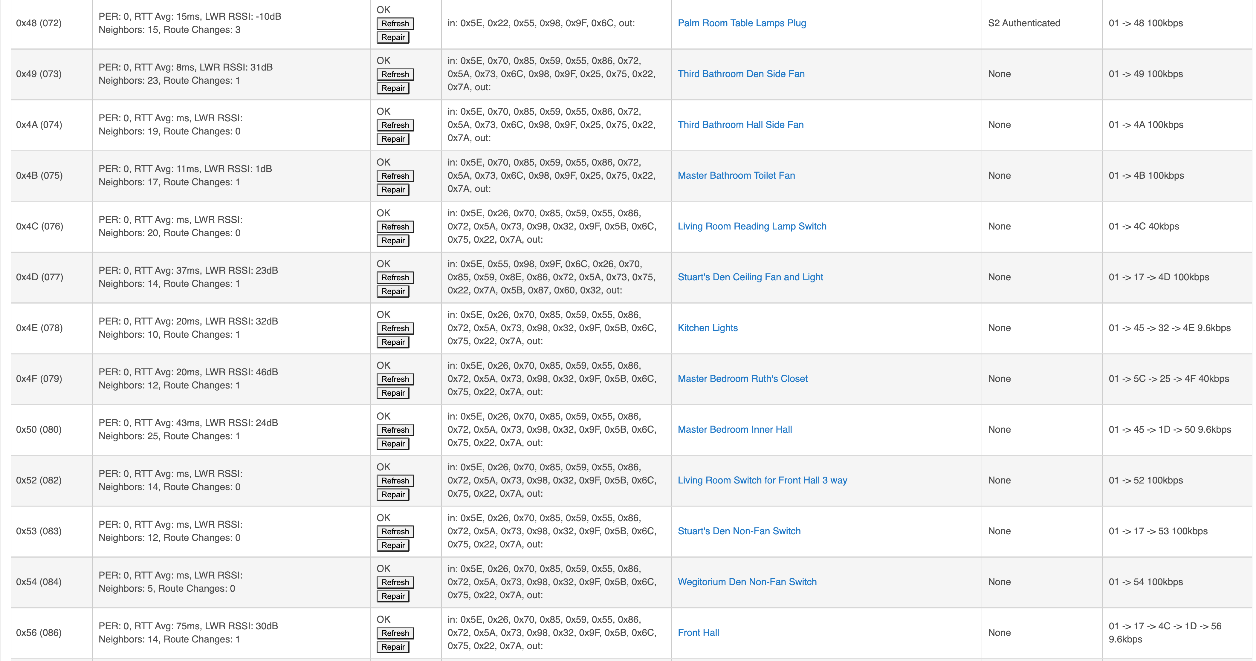

I couldn’t get final device that still had S2 security, an Aeotec Smart Switch 7, to go into include/exclude mode no matter how I clicked the button so I did a factory reset and was able to include it with no security. I gave it a different name then before.
After I did that I saw the old device was still listed in Z-Wave and Device tables. So I then did a “repair” from the Z-Wave table which removed it from there. But it was still listed on the Devices page. So I went into the device and did a remove from there which did remove it.

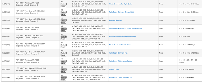

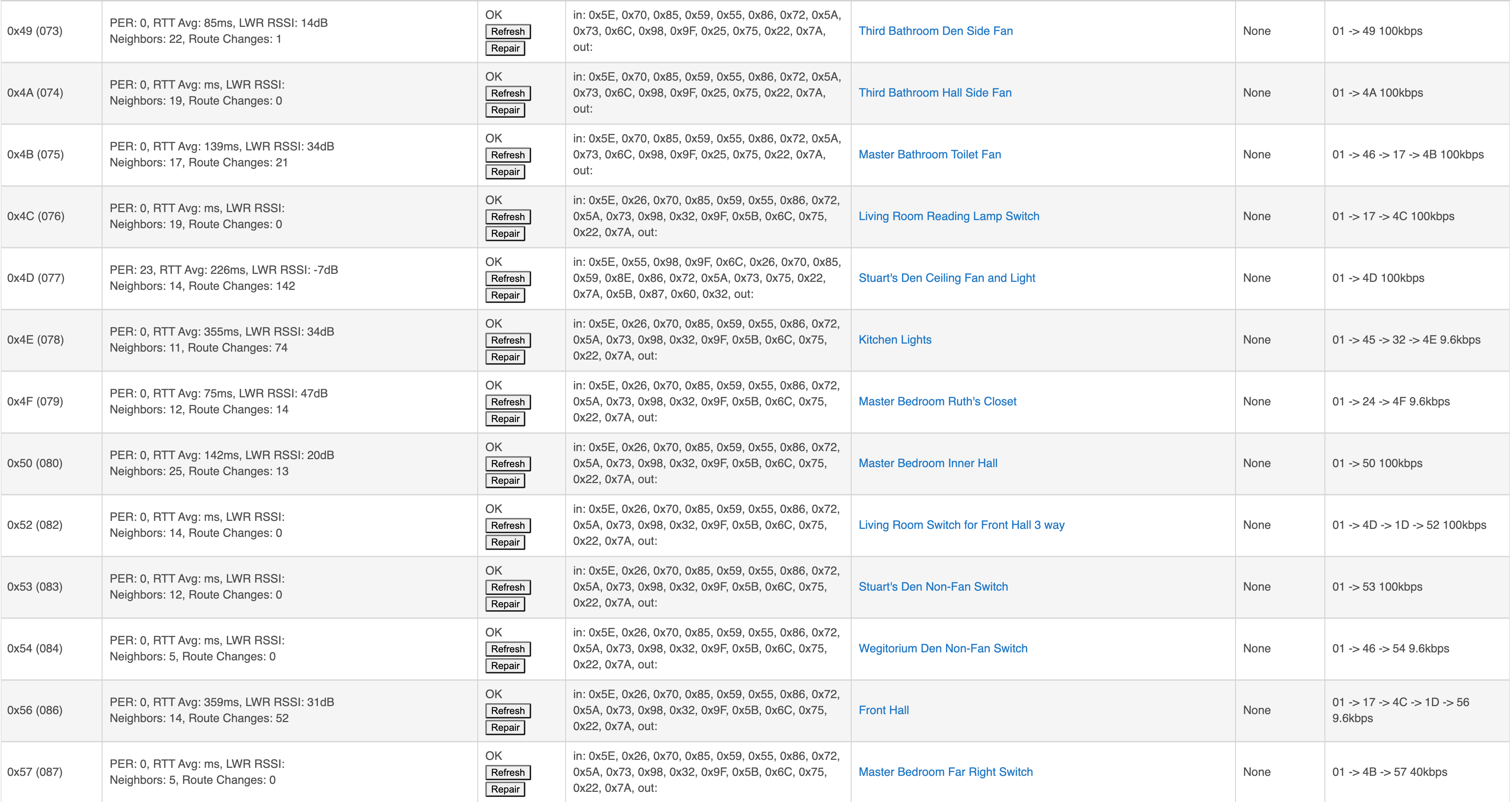

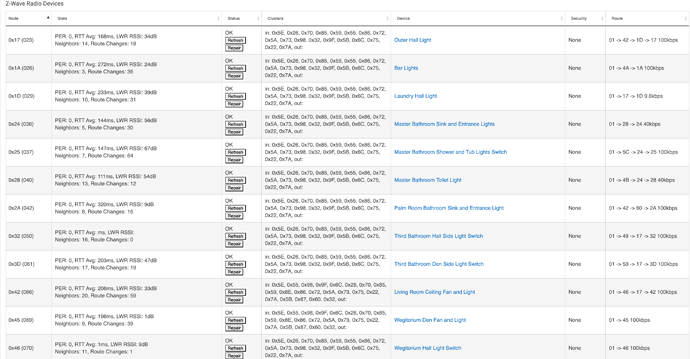

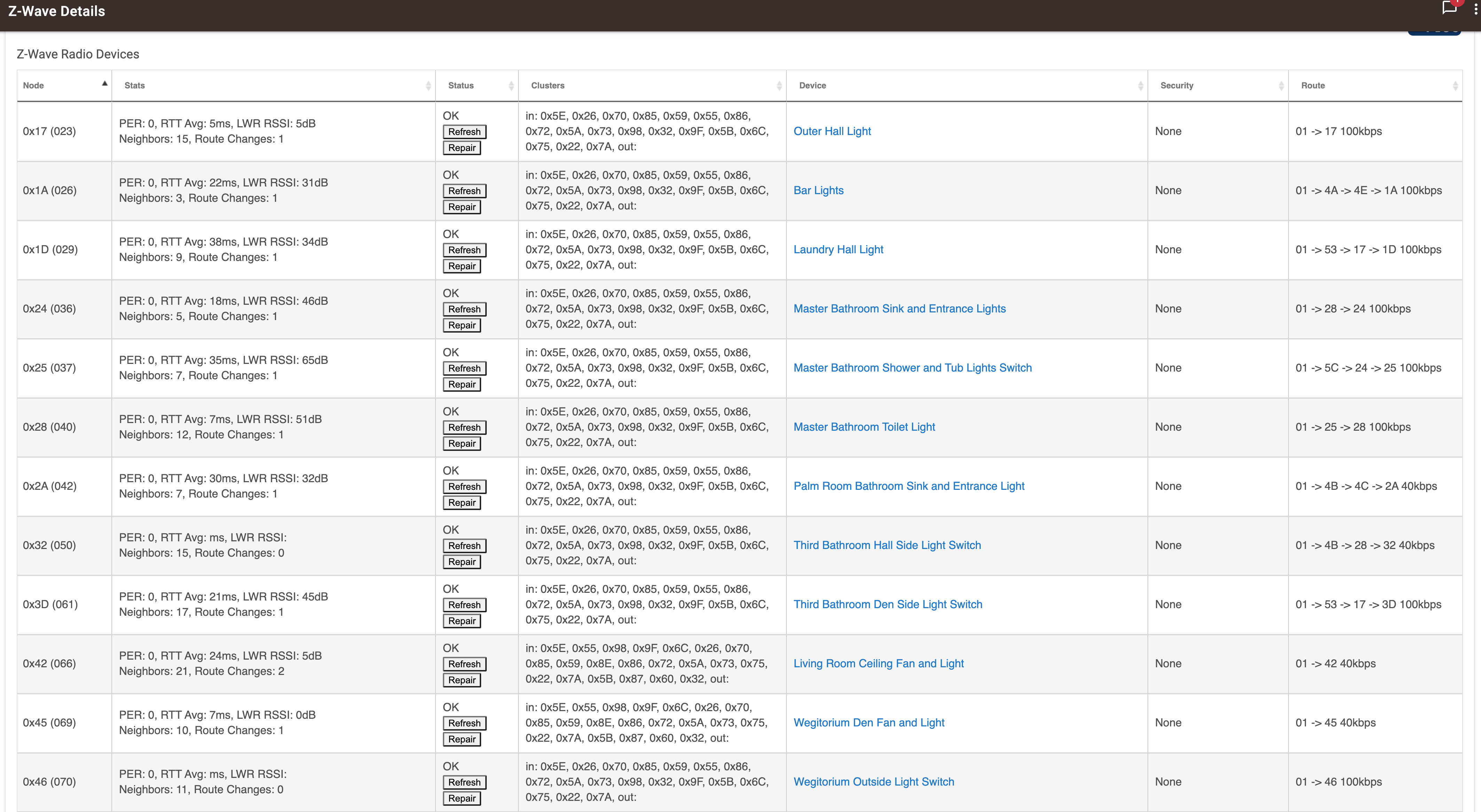

Even though there are 2 switches inside the same room as the hub I see very few paths on my Z-Wave table going through them and many, many more going through another switch, #17 on the table below, which is the first in the list and the first I ever installed. It is actually outside of the room the hub is in and on the far side of that hall. The 2 that are in the same room as the hub are 45 and 46.
As these are all wired switches they shouldn't ever be going to sleep, but I've definitely seen, and posted about before, situations where it takes a long time for a rule to react the first time but much faster after that.
I've already done a total mesh Z-Wave repair, but I'm wondering if I should do it again, or maybe, if there is a way to do it, one-by-one to sort of force a path. (Pushing repair one at a time from the Z-Wave table?) I'm not sure what that might have to do with this lag issue I've been seeing but I don't know what else to do.
Here is my Z-Wave table below. My hub is in the same room as 45 and 46.
I have repeaters in the same room as hubs sometimes they get used most times they don’t get used. I stopped looking at paths a long time ago, they will probably never make sense to you. My zwave network is really fast and reliable since I started using a separate hub for zwave & zigbee its probably not the reason why it’s fast but nothing else really changed since adding another hub, zwave devices are all in the same place just a thought.

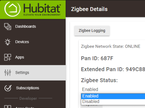

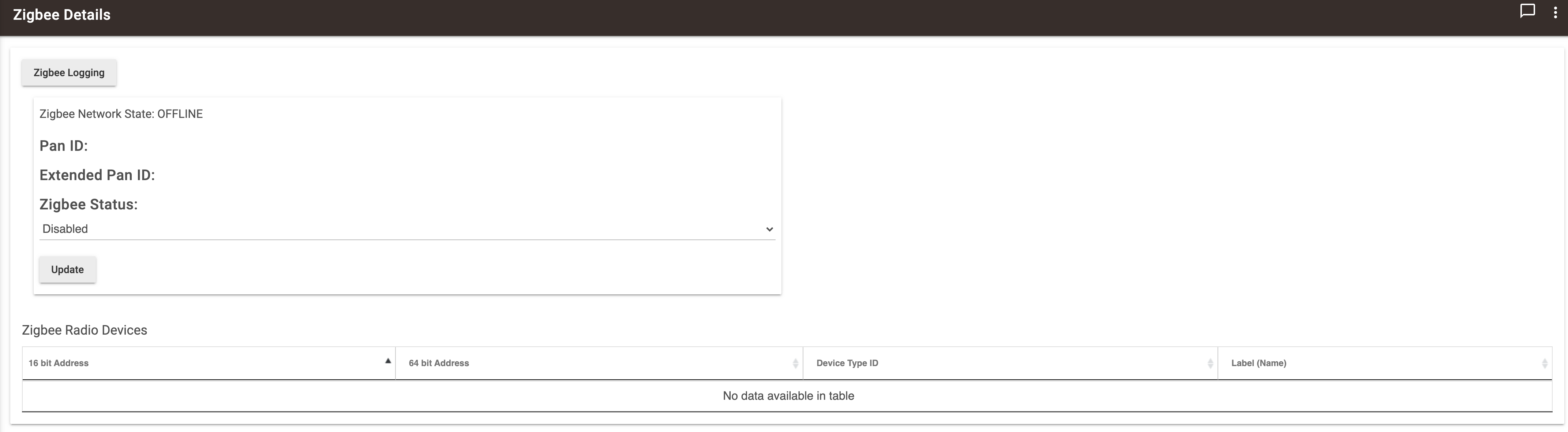

Hmm. Did you disable zigbee on the z-wave hub?
I have very little zigbee on my Hubitat--just 5 buttons. Seems like that shouldn't be a huge issue. But I am rather desperate to figure out why my hub is so wonky.

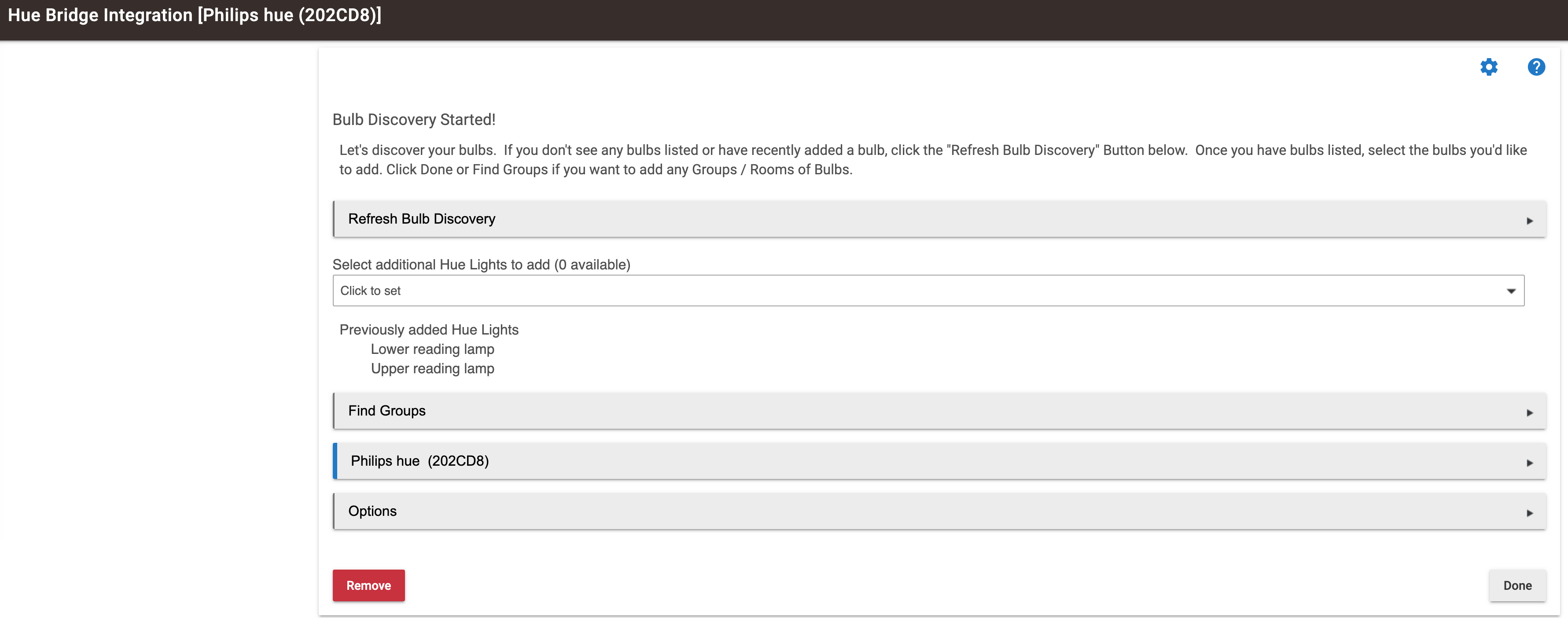

As far as I know I don’t have any Zigbee devices, but I’m not sure how my Philips Hie bridge and bulbs work as they were given to me.
If you're using the Phillips Hue bridge--chances are the hub is interacting through their integration (pretty sure Phillips is Zigbee--but it's the Hue hub that is doing the "Zigbee" talking and the Hubitat is talking to the Hue Hub in some manner over TCP/IP).
My question was about whether or not you DISABLED the Zigbee radio on your Hubitat. I'm guessing not.
No I haven't. Would that affect the Hue bridge/bulbs then? If not, can you please tell me how to do that.
All your hue devices are connected to the bridge and not direct connected to the hub, correct?

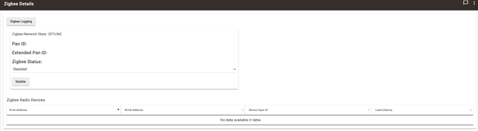

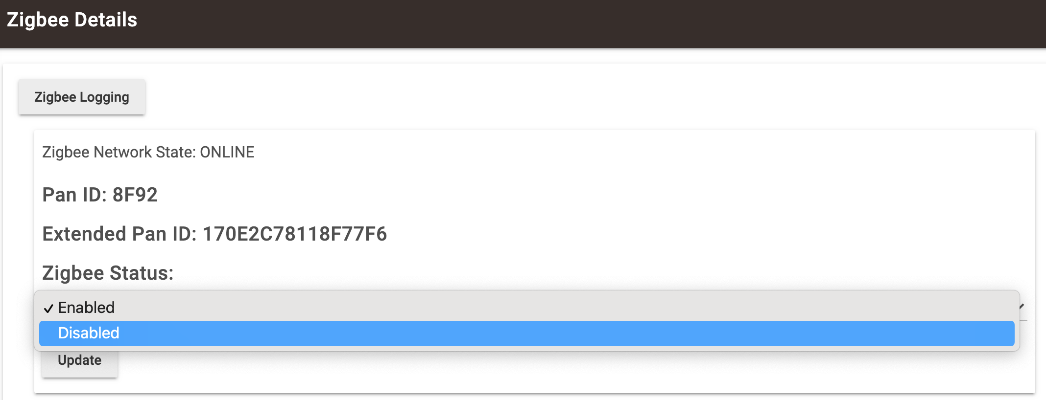

Settings, Zigbee details, and select disable from the drop down.
I've now disabled it as I clicked Disabled then the Update button:
Before:
After:
I think the bulbs are going through the Hue integration.
And from the above screenshot the Zigbee Info isn't listing any Zigbee devices.
