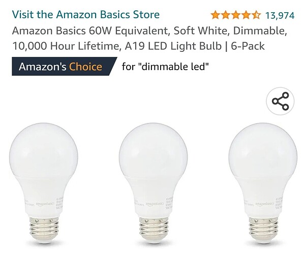

I usually order bulbs from Amazon and they will say if they are dimmable. Lots of choices. They usually dim OK. If they don't I send them back.
As a self described CT bulb specialist - may I add be sure of the color temp as well in your purchase. I'm using dimmable Tuya multigang modules and was swearing at things one night recently, before I realized the bulb CT was the fault! The amazon units noted above have problems with sub-5% settings, but few if any people take a bulb down that low.
