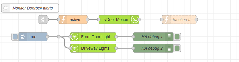

I've seen user's past posts showing their flows using the HE nodes. In them, below the node shows the state of the flow. In my flows, only the Mode node shows its state. How can I enable the state below other nodes?

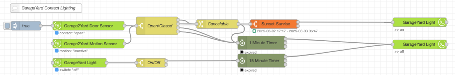

Ok, what is confusing me is in your flow, your "device" nodes show status. In my flow below, none of my device nodes are showing their status. Any idea why?

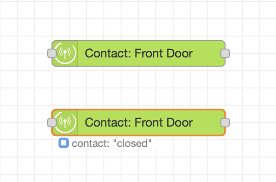

Yes. You haven't selected the specific attribute whose state you wish to be displayed below the node.
For example:
Screenshot 2025-03-02 at 4.06.07 PM
The difference between these two nodes is that in the upper one "All" attributes are sent in messages, whereas in the lower one, only changes in the "contact" attribute are sent.
Well duh (wiping the egg from my face)... thank you for showing me how to resolve this
