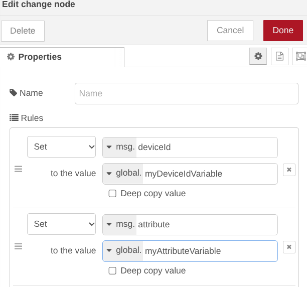

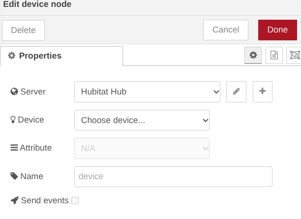

Edit: I wrote the above from my phone before checking Node Red. You can set the deviceId and attribute in the input to a Device node, so if I understand what you're trying to do, you can already do it with the existing nodes. In the sub-flow just set the values from your variables and pass them to a Device or Command node that only has the server selected.
Change Node to set message parts from global variables:
Hubitat Device node with no pre-set device or attribute:
Test flow
I set the deviceId to 1 and the attribute to "presence" and get this from the debug node:

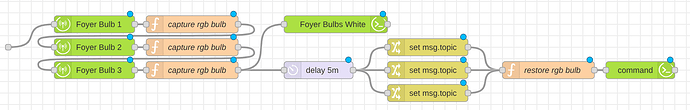

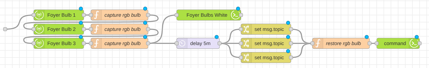

I use this method in some flows that capture the state of a RGB bulb and then later restore it. The capture is done by a function node that stores the attributes of the bulb to flow variables. I have a single Command node in the flow to do the restore function. It gets the deviceId, command, and arguments from the incoming messages.

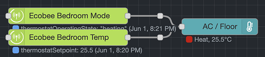

The "AC / Floor" subflow has all the logic in it and it's reused for each room / thermostat.
I'd love to have done this with a single triggering node, but it needs to go through the logic if either the mode or the temperature is changed in the thermostat.
Anyway, it now looks clean an tidy :grin:

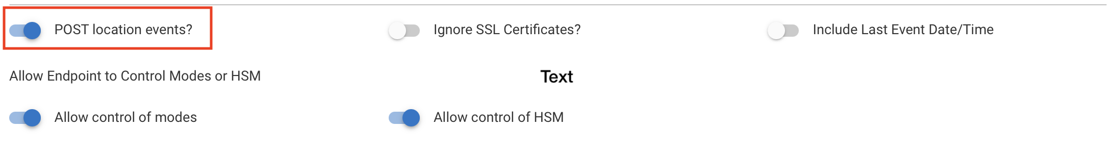

Can you check your webhook configuration for MakerAPI and confirm if "Post Location Events" is enabled? That's about the only thing I can think of now.
Bingo! That was it. Much appreciated. I migrated from my original C4 to C8Pro back in Jan-Feb. So I missed 1 thing out of 200 :confused:

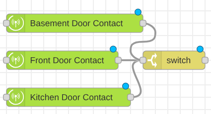

Just as one example of where I'm using this, I have a flow that triggers when any of 3 door contacts opens. That used to look like this:
It had one device node for each door with 'Send Events' selected, plus a switch to only pass 'open' messages. Now that is a single node with 'any' and 'open' selected.
The two do operate slightly differently, as the original will trigger every time any door goes from closed to open, and my logic gate trigger will only trigger when the whole group goes from 'all closed' to 'at least one open'. For the purpose of my flow that works just as well.

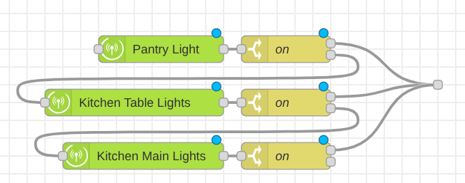

As another example, this snippet checks three lights to see if any are on. The message passes to the junction node at the first 'on' device:
That is now this:
The node status message works like the other Hubitat nodes where a solid icon (gray for false, green for true) means it will send events, and an icon with a white dot in the center means it will not send events. The node shows the last time the true/false state changed. All three nodes append the number of selected devices to the node name and update that as you add/remove selected devices.

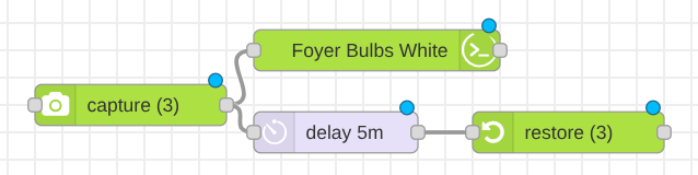

Here's one example. This flow snippet captures 3 bulbs, turns on a Room Lighting activator to turn them on in CT mode, then resets them to their former state after a 5 minute delay. It used to look like this:
I had to pass the message through 3 device nodes, 3 copies of my capture function, and use change nodes to send three separate messages to my restore function. Now it looks like this:
